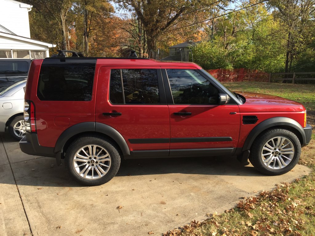

@umbertob
I've have new LR tpms installed for 2 weeks and they won't sync up. Dealer wants $75 to get them to sync.
Will the Gap tool work to sync them?
Installed new tires and rims 20s
Thx
umbertob
Apr 18, 2006
2,701
428
California, USA
Sorry man, little late to the party. If these are for your 2008 LR3 - that photo tricked me for a second, lol - I believe newer sensors from an LR4 (even of the same frequency, 315 MHz) would not be compatible with the earlier system installed on 06-09 LR3s in North America. IIDTool can only deactivate the system, but is not able to manually program the individual sensors into the TPMS module, although I don't think even a dealer would be able to do that if the sensors are not compatible to begin with.
