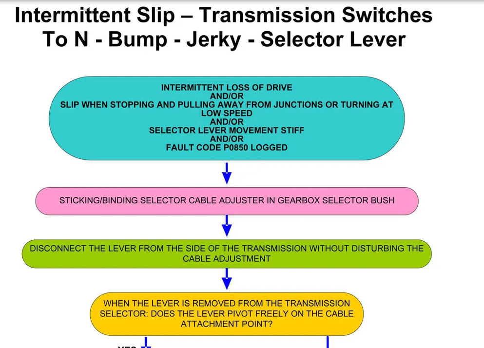

I had a similar issue 2 weeks ago with my transmission not engaging after putting it in Drive on a cold morning (Your second issue). My wife drives the LR 80% of the time so she drives back home after leaving 5 mins prior and says the car is acting funny that each time she stops at a stop sign or traffic light and she tries to start moving the car would just rev up and not go then a few seconds later it would now start moving. So i had her take my car and i took the LR for a drive to see what was happening...I almost hard a heart attack when i realized the tranny was slipping but only in 1st gear when you stop and attempt to start moving, once in 2,3,4,5 gear all is well. Then i stopped turned the engine off, started and put in D and nothing happened the car would just rev up and not move and then engage a few seconds later. So i drove back home with my heart pounding each second of the way. Luckily i had bought all the fluids back in december, tranny oil, diff oil and TC oil and was all sitting in a box in my garage hoping to change everything once the weather got better. So i went back inside the house and dressed up like an eskimo and i raised the LR on 4 rhino ramps and changed all fluids including the engine oil. Initially i was thinking the tranny fluid was low or that it was leaking somewhere but when i got under the car, it was bone dry everywhere and i drained exactly 4 liters. Anyway went for a test drive keeping my fingers crossed...
it happened again about 3 more times and eventually after about 3-5 mins of driving the tranny went back to normal. I have driven about 1200km for the last 2 weeks and it has not slipped one time. The last time i did the tranny service about 2 yrs ago roughly at 178,000 i used FEBI tranny oil so i'm thinking maybe Febi is not as compatible as they claim. I used ZF fluid this time around. Currently the LR has 215,000km. I'm still driving with no issues and i also noticed all prior rough shifts have disappeared
So ThinkGadget i would advice to try changing the tranny fluid and make sure to use ZF fluid.

https://www.rangerovers.net/threads...ear-at-light-after-driving-for-a-while.47764/
Apparently this was my issue not the tranny fluid. I had the above procedure done and my car has been fine ever since.
