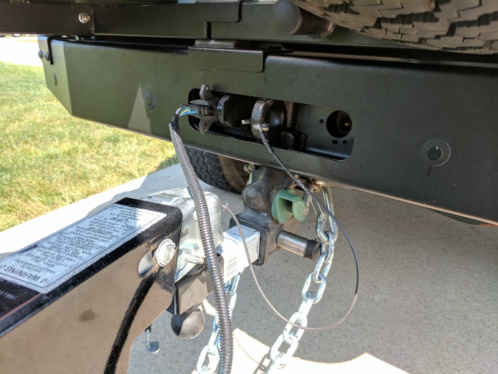

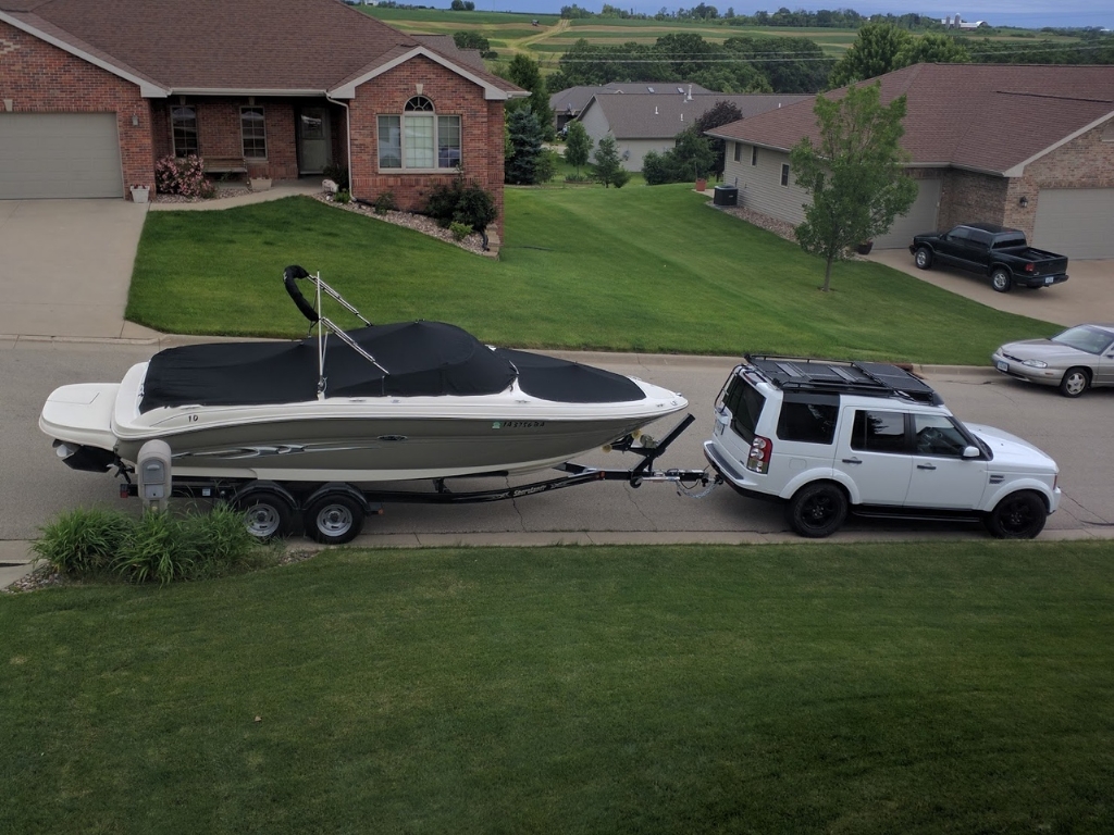

Old photo, but this was my 26' Sea Ray bow rider. Dual axel trailer with hitch actuated trailer brakes. LED lights that worked, but didn't have enough current draw to trip the trailer mode on the LR4. Weight must have been just about 7,000 lbs. I used the factory hitch setup. The second photo is the same boat/lr4 but when i added my Tactical 4x4 rear bumper.

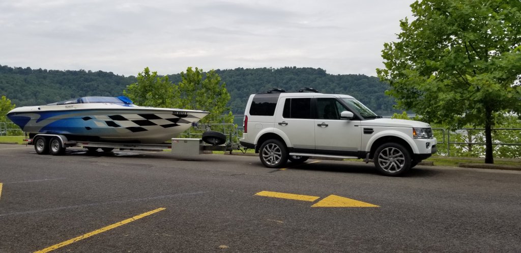

I tow around a 19' jet boat that comes in at about 4200 lbs on the trailer. Stock hitch & wiring. Tows it great, I've had 7 people in the car + more gear in the boat, and it did well with 117 degree temps. Honestly the sketchiest part is I swear this car can outturn the trailer (going forward) and jackknife it.

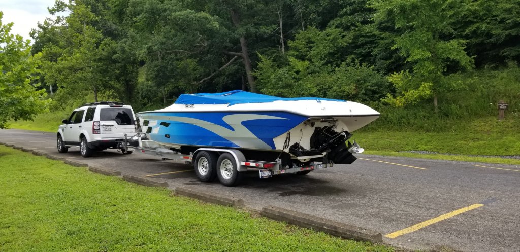

Our 29' Velocity. 4500lbs dry, trailer is another 1000lbs. Hyd surge brakes. Stock LR hitch setup. I tow the boat with wife's LR4 and my 5.3 Sierra. While the 5.3 V8 makes more hp and torque, it's all above 4400rpms+. The torque curve on the SCV6 is stronger at anything below 4000rpms and towing really confirms that. The Sierra has a wider track and longer wheelbase vs LR4. Boat feels more planted and less subject to steering changes with the Sierra. Stock LR4 mirrors are not wide enough. Overall the LR4 is better long tow vehicle due to comfort and power.

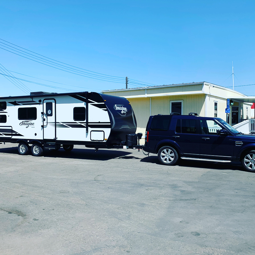

I use my 2015 LR4 to tow my 2020 Grand Design Imagine XLS 23BHE. Currently using the stock hitch receiver and no weight distribution. I use a Curt Echo wireless break control and love it. I use a WeighSafe hitch with built in scale and my tongue weight is right about 600/650lbs and overall weight of the trailer is 6,000/6,100lbs...that's loaded for a trip but with only about 25% fresh water in the fresh tank. Black/Gray tanks empty. I'm in the process of reweighing the whole setup as one of the last trips my Cat ticket showed 4,400 on the rear axle which is over the limit. My current guess is that the specific Cat scale I went to may have been off?? I did weigh just the LR4, full tank of gas, wife, kids, a bit of cargo at a different Cat scale and my rear axle was at 3380lbs. Next step is to hook up the trailer and weigh again. Given my tongue weight is 600 (sometime 650lbs depending on how I load) I should be within the rear axle weight. What I'd really like to know is how all these weights play out on a new Discovery/Discover 5. Land Rover claims that it's up to 1,000lbs lighter than the LR4 and the states payload capacity of the new Discovery is more than the LR4 as well.
