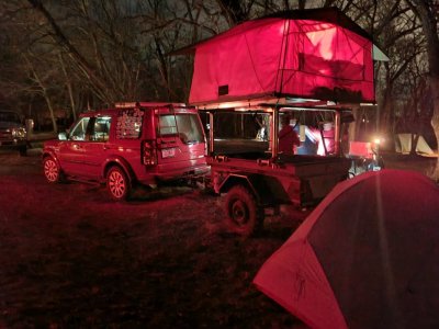

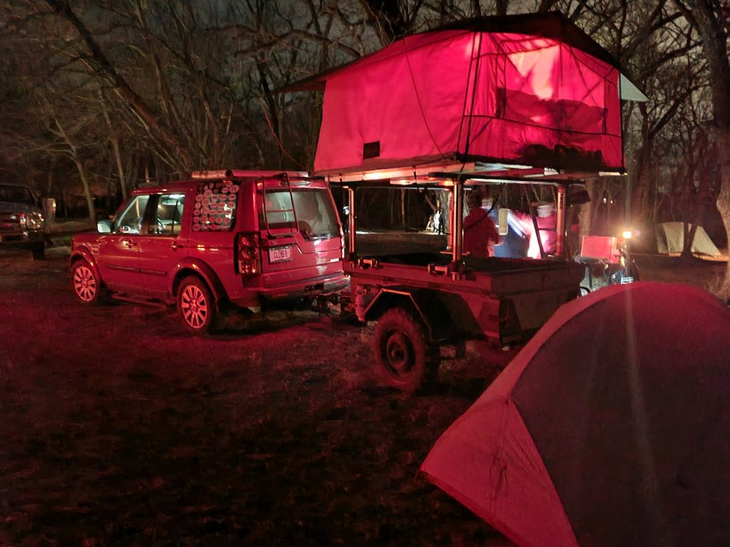

Meh! Here's some serious towing weight.. This weighs 1,100 (Eleven Hundred) pounds full of food, beer, and backpacks, and has a crippling tongue weight of 30 lbs.. In all honesty, I can't even tell it's there when I'm on the highway..

I've been wanting one of these!!!
Is that an M416?
The addition of an 80lb dog has taken up too much space in the back. Trailer looks awesome.

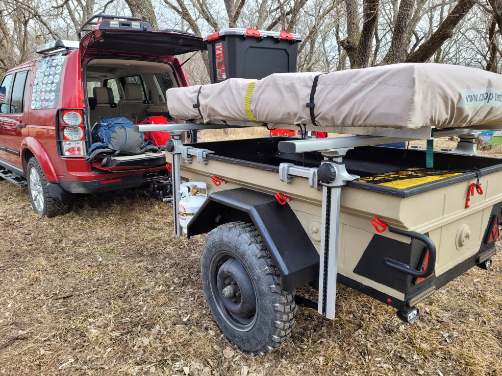

Close, it's a M101CDN2- a beefier, updated version of the M416. Excellent overlanding trailer, and a fun project that you can build as you go. 20210227_190318.jpg

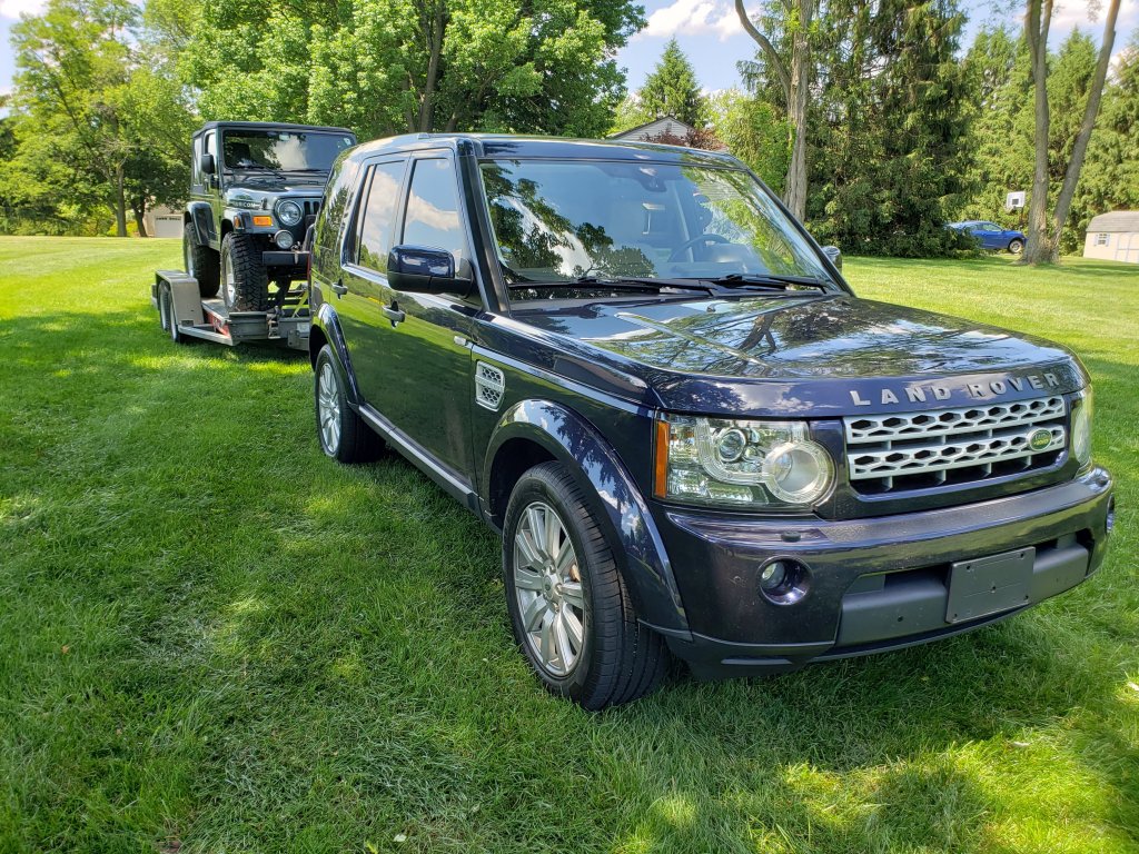

Towed my Jeep TJ to a Jeep event last year. Jeep is about 3900# and the trailer is a little over 2k, so call it 6,000#
Going and stopping were great. Handling is better with a longer truck.
I got some sway in the setup initially but I moved the Jeep forward another two inches and it went away.
Finding the balance of tongue weight and stability is crucial, always err towards maxing out tongue weight.
