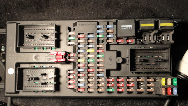

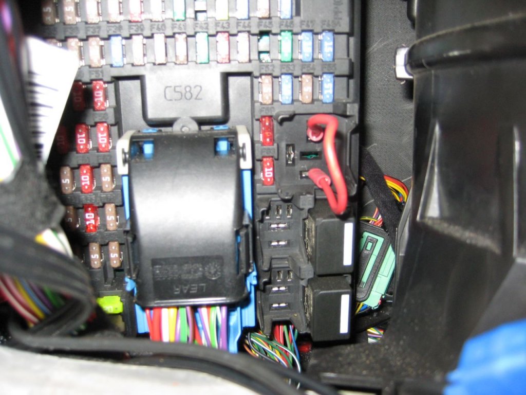

You don't need to mod the relay. Just remove it, and make up a 3 inch or so jumper using male spade connectors on each end.
The jpg attached is the glove compartment fuse box in my 2005 LR3 HSE; the LR4 may be different.
The red conductor jumper location located above the two lower small relays is the location of the "big" relay that I removed and replaced with the jumper.
That was many years ago and nothing bad has happened since other than some of my power sockets now remain powered 7/24/365.
If I recall correctly, the fuses that protect the sockets are still in the circuit as they are located down circuit of the relay.
Passenger Side Fuse panel removed dsc01807ck.jpg LR3 CJB Relay R1 jumper permanent aux sockets.jpg
The other jpg shows the glove box fuse panel with the big original relay in place.

...The red conductor jumper location located above the two lower small relays is the location of the "big" relay that I removed and replaced with the jumper.
That was many years ago and nothing bad has happened since other than some of my power sockets now remain powered 7/24/365. ...
Some? I guess the LR4 may be different. Curious which ones are now constant power.
So, I am guessing that if I do this I just have to be responsible and not leave a power sucking device attached that'll drain your battery. BUT, leaving a cell phone connected, for instance, would not be a concern.
THANK YOU for sharing the photo.
