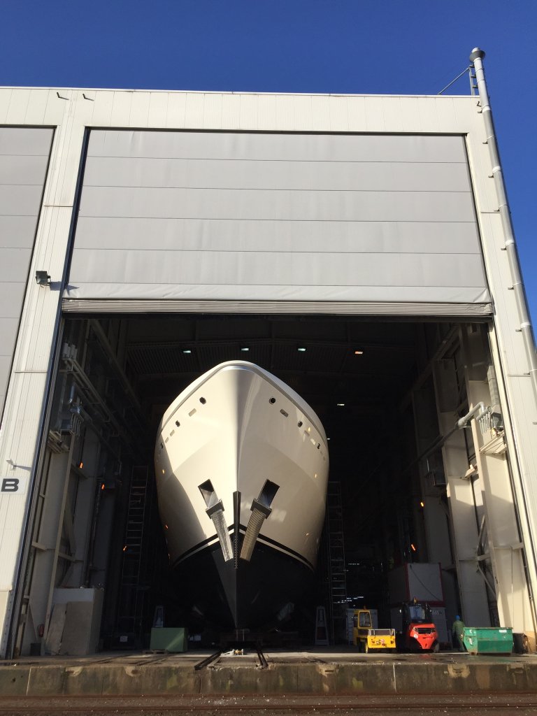

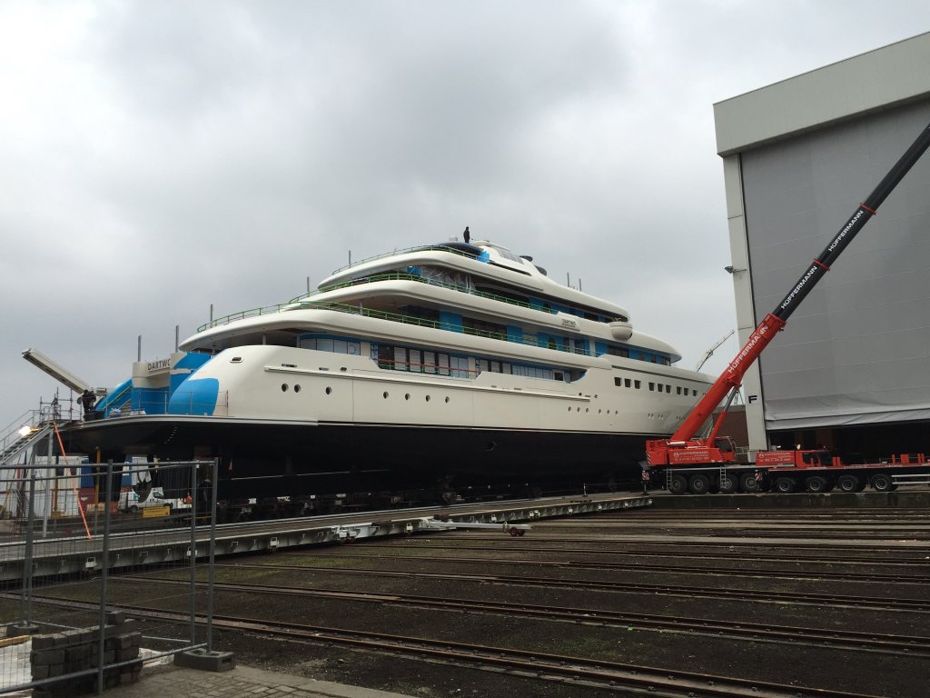

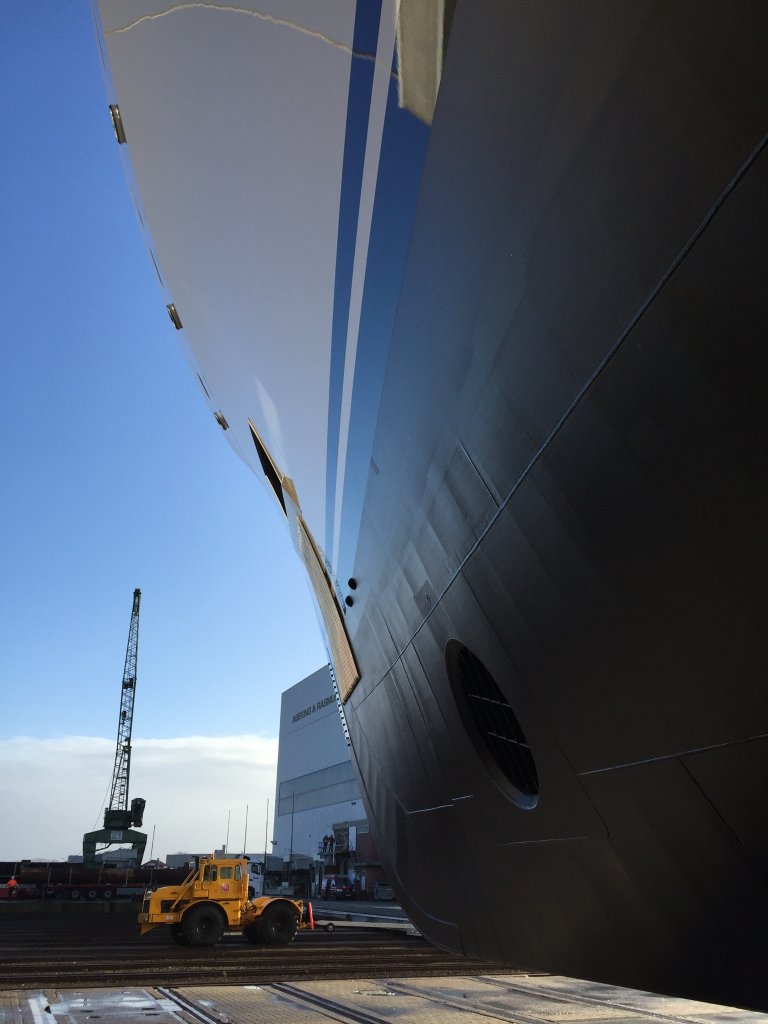

The last one was aberking and Rasmussen just outside of Bremen.
The East German mog rip off was dragging this bad boy out of the construction shed to the synchro lift, used to be a slipway but they upgraded.
