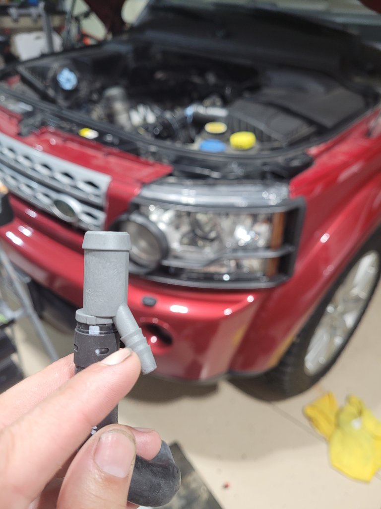

Hey Guys!
I got into this job about 2 hours ago, and it wasn't long before I snapped that small plastic coolant line off inside the front of the water pump. It looks like there is a redesign that is mentioned in the beginning of this thread, using the LR045238 and the LR049989, but from the pictures this doesn't make sense. Follow my logic:
1. In the new design, that small tube going into the water pump is now located on the large hose coming from the thermostat (the LR049989).
2. Also in the new design, the LR045238 shows the outlet for the same small tube to the water pump.
Is the outlet on the LR045238 capped off? There is now nothing that should connect to it- coolant is now supplied by the LR049989.
Thanks for the help, this one's got me confused..
Mike

I’m in the v6 so the parts may be a little different. But the small part you broke does come with the hose from the thermostat.
I do however have the old little plastic piece that you broke. If you want it then pm me and I’ll get it out to you.

Thanks Stuart, wish I would have read this prior to heading to the dealership.. I'm $80 lighter, but at least I got an answer:
In the pic below is the LR045238. My assumption was correct, the connector that my finger is on is indeed capped off internally. So I'm back on track.. Halfway through!
Mike
