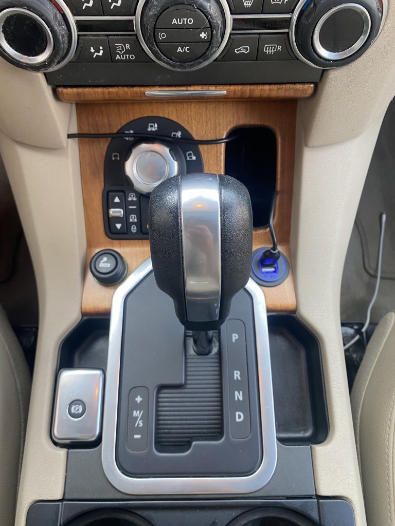

Reviving this old thread, because it's great!!
Just installed on my 2011 LR4 HSE. Thanks for the tutorial and photos fellas. Had to Dremel the hole up and right just like @Pfunk951 did.
I noticed it gets powered on as soon as you unlock the car, and does not power off until you either lock the car or the 2-minute delay is over. Hope it isn't significant enough over time to drain the battery.
