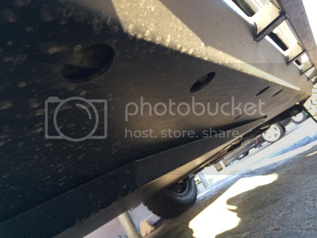

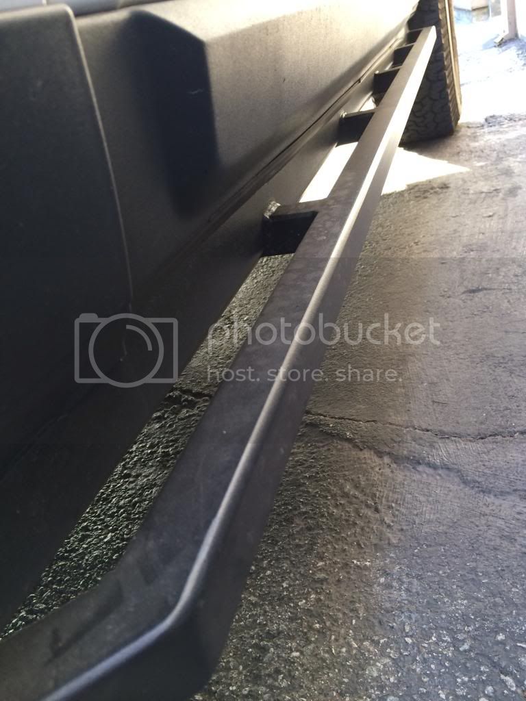

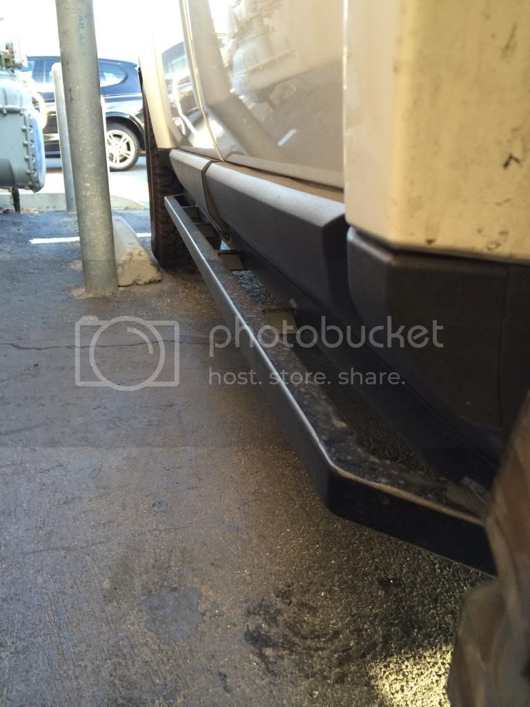

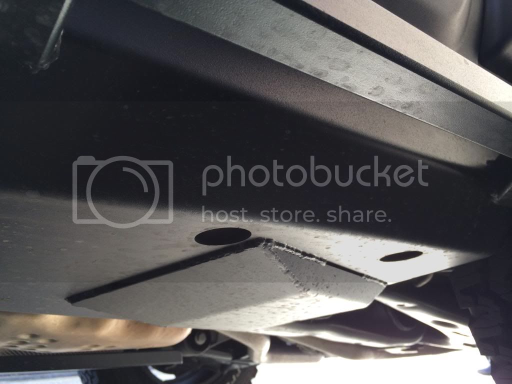

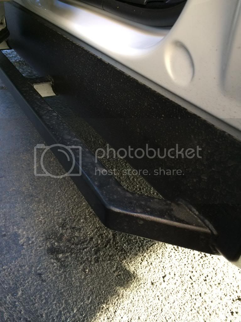

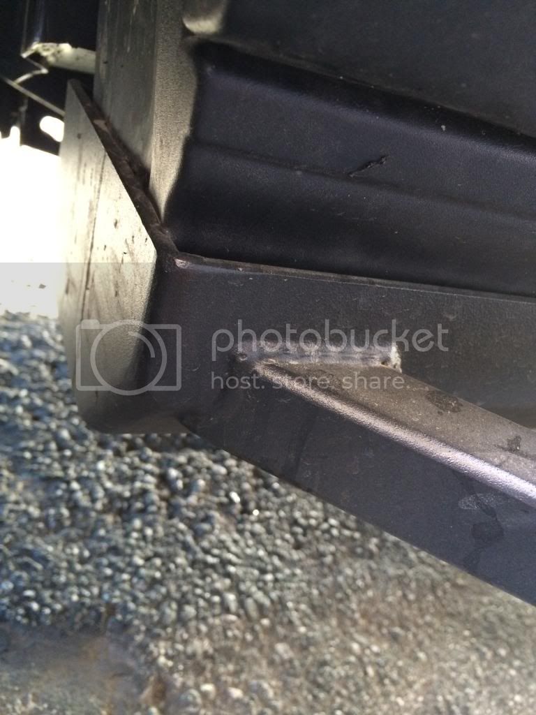

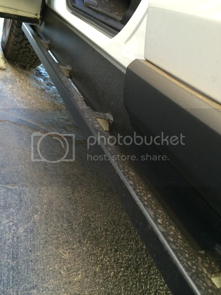

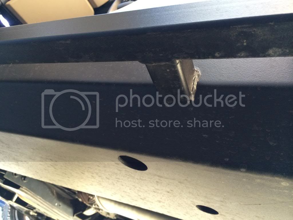

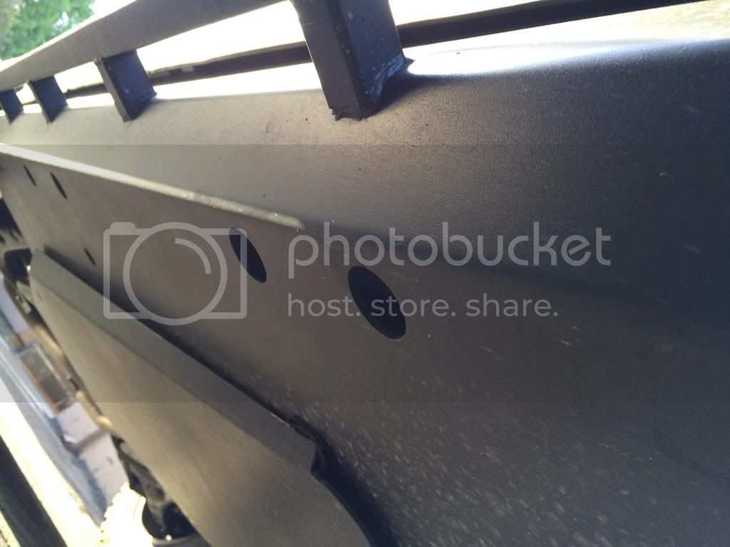

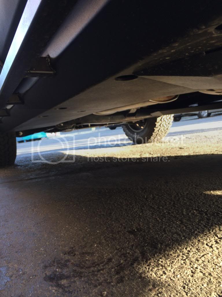

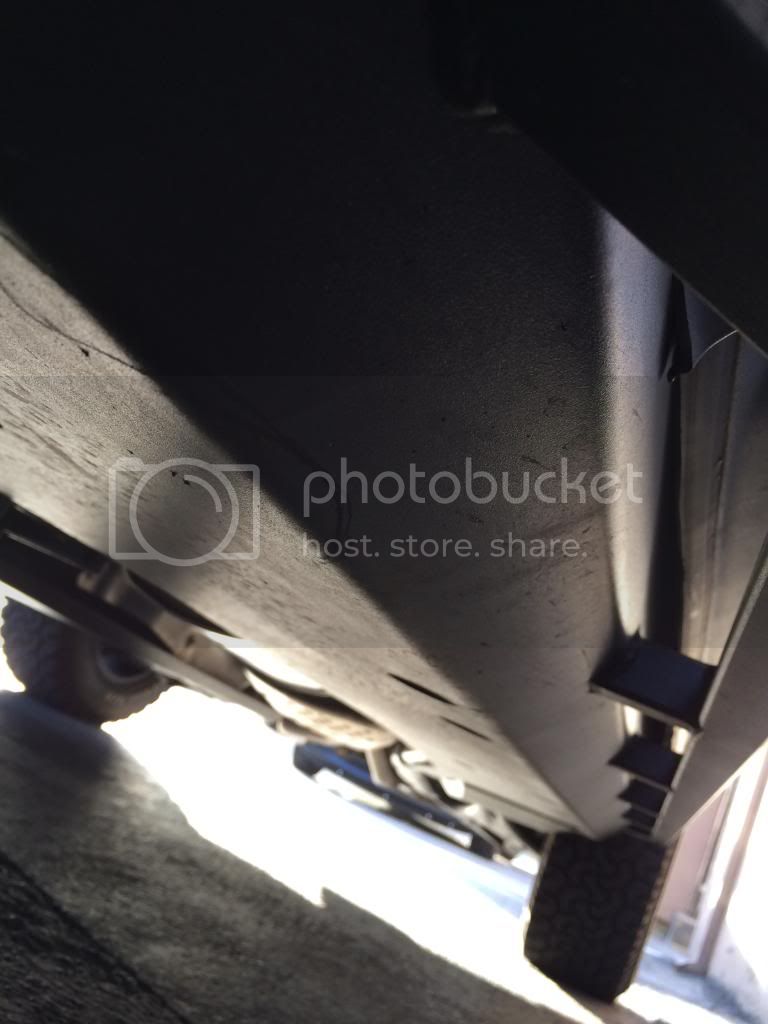

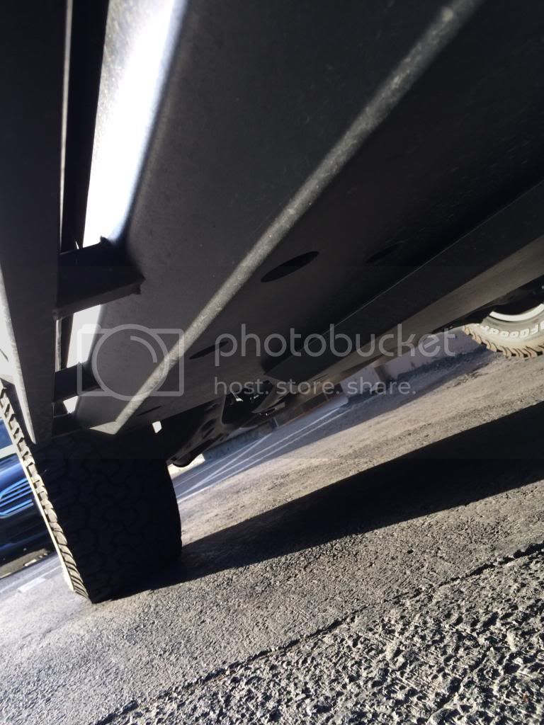

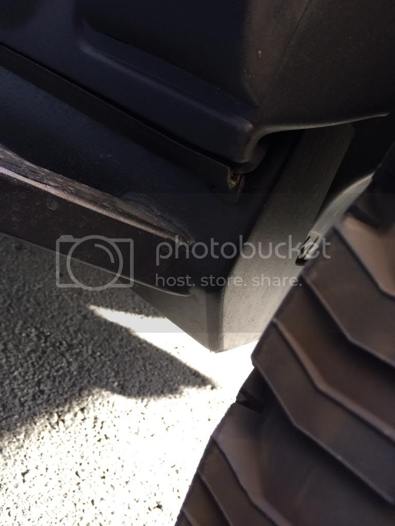

Hey mbw,
I just got back from my local independent LR garage (they sponsor our off-road club). As you know, I had problems with my Tactical 4x4 sliders creaking, as have others on the forum. We ended up not having to completely drop the sliders, but rather loosened up a few bolts, pryed them down a bit, and then was able to put some thick neoprene-foam material in all places where the sliders touch the frame. I had 2 six-foot roles with adhesive. In addition, I used LocTite on all of the bolts (2 huge body bolts and 6 additional bolts - on each side).
I am happy to report, after about 5 miles of various types of road tests, there is absolutely no creaking at all - it is now dead quiet. Awesome! Plus, I am very happy it's an easy fix if I need to do it again down the road.
So, if you guys do install the Tactical 4x4 sliders, take some time to apply rubber/thick foam to ALL AREAS where the sliders touch the frame. In addition, if you have the gas tank skid plate, you should apply a sheet to the middle of the plate that is closest to the gas tank and the end where it it almost touches the slider. The transfer case skid plate is fine, it does not touch anything since it is held by brackets.
I snapped a few photos last night, but can do more when I use my drive jacks this evening. As always, let me know if you have any questions and I will get you some better photos.
