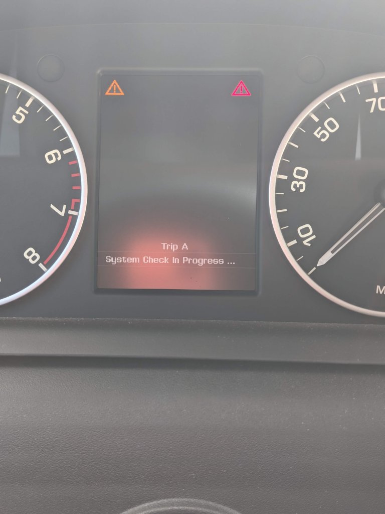

Any updates? My truck is experiencing something similar. Didn't drive it for a day and even though the battery is reading 12.5V resting, I got the low battery warning on the IP when I opened the door. Battery is a one month old Interstate from Costco. FWIW, it had trouble starting a week ago and the IP LCD was stuck on this mostly blank screen (pic attached). Didn't even get to the point of trying to crank, seemed electrical. Can't remember if I even heard a click. Anyways, I tried to wiggle the battery cables, but they were on tight and the truck started after I tried again. Ever since then the dome and door puddle lights also flicker whenever I put the truck in park with the engine running after a drive. They're swapped LED's, but never flickered prior to No Start occurrence.
