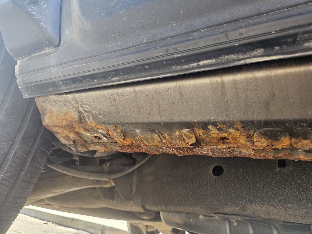

2010 V8 212k km:
New passenger side front brake caliper
New drive shaft (front to rear)
New pads and rotors (front)
Took plastic sill covers off - not pretty :(
Rust killer and woolwax treatment pending. No holes, but should have looked at earlier (owned since 2018)

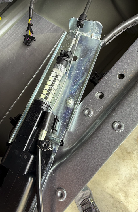

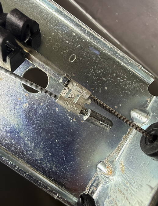

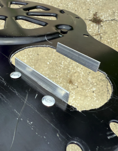

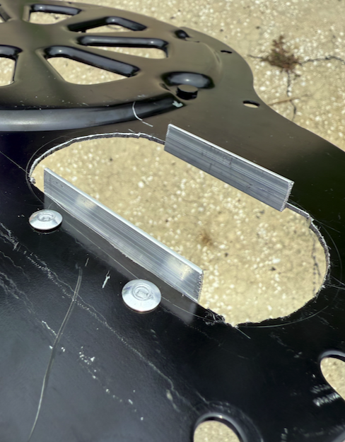

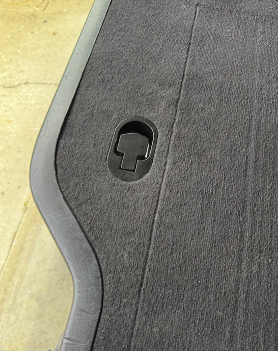

I have had the rear hatch issue in the past and I figured it was time to be proactive about preventing any issues in the future. Did the install based off of this old Expedition Portal thread: Latch Mod. Lucky 8 sells a kit from Italy, but Im not spending that much for something you can spend a quarter of that on.
I didnt get as complicated as the linked thread showed, but I bought a cheap reclining chair latch, some cheap thin sound dampener, and some aluminum angle. I opened everything up, set the new cable and used a female electrical spade connector to connect the two cables together. I used some safety wire to hold the cable on a post within the actuator assembly. Everything felt solid, so bolted the actuator back in and closed the rear up and tested it many times and it worked. I then created a template and cut an opening for the latch on the subwoofer housing. A bit of trial and error to ensure everything fit well. I riveted the aluminum angle to screw the latch assembly to. Cut hole in carpet panel (probably the hardest part as I went slow here so that I didnt make the opening too big). Put it all back together and good to go!
