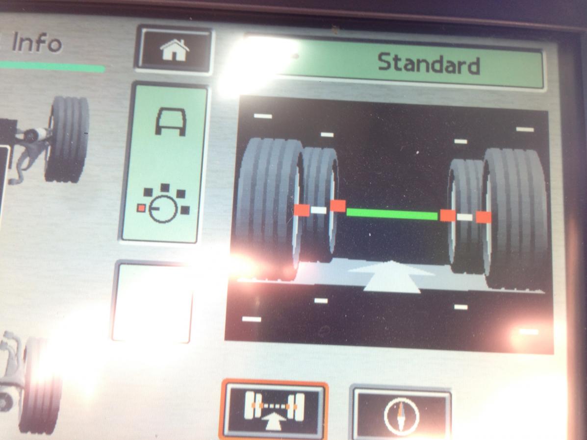

However today after lunch when turning on the car I saw this on the 4x4 screen (note the front left missaligned) and it immediately threw a suspension fault, I turned it off and on and I lowered directly into access mode, then to normal height again and the fault cleared and the wheel aligned. This however would not explain the lowering with the fuse disconnected would it?

No, I suppose it wouldn't. If you're going to keep this vehicle just get yourself an IIDTool already. We could be doing such a better job troubleshooting if you had one. At this point we are shooting in the dark.
