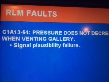

So it doesn't leak anymore yet it beeps another fault (this has become a bloody comedy right now) it says "pressure not decreasing when venting the gallery" my indy couldn't fix it. He threw the towel and said the compressor is ****** up.
The only way of getting the compressor to start is by turning the vehicle on with the door open? Only that way the pressure is vented and it works normally. After a bit of driving the fault returns.
WHY????
I mean it DOES vent but ONLY if the door is open. He said he reflashed 3 times, I am thinking of going to the dealer but they are such corrupt pigs that they will most probably tell me I need a new compressor you now they can charge much more for that than for reflashing

This is the only fault
