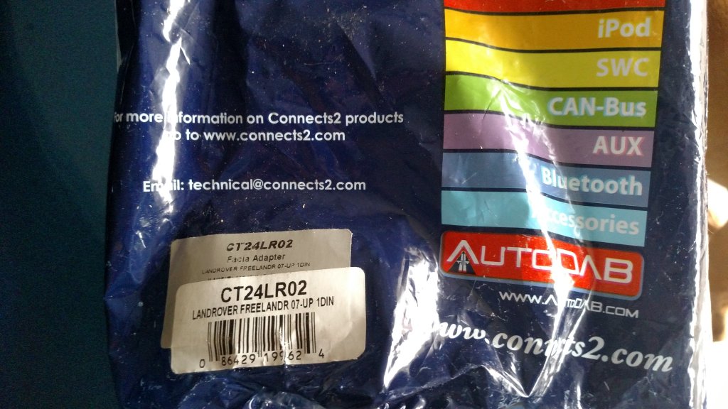

Thanks, I thought about adding a factory Nav but still wouldn't have satellite, etc. and I like that cubby to store stuff in. I used the Nav for the first time Sunday and really didn't have a problem because 95% of it is verbal directions. The steering wheel functions are Mode: toggle between Sirius, USB, Radio, and Aux. Up and down change the volume, fast forward changes the station in Sirius and track in USB playing music files. I'm hoping someone can help with the output impedance for the rear speakers so I can get full audio in the rear.
Also above is a pic of the face plate I bought to add the double DIN radio if anyone is interested.
