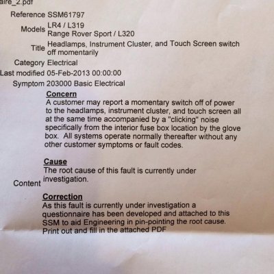

I recorded every detail of the issue and LR was able to trace it to a ground wire that is short and prone to working itself loose. If your issue is low speed only, particularly when accelerating from a stop or near stop, involves clicking from the glove box area and your headlights and audio cut out momentarilly, I suspect the same ground wire has come loose. I am issue free for about a week.

Oh yeah, this was left in my vehicle also...
