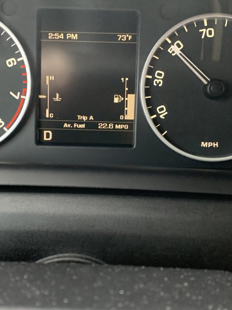

This is unexpected. Usually get about 16-17 average around town and this shows a marked improvement. No adaptation reset yet.

Just did a 350mile round trip to Asheville. She’s never run so smoothly since I’ve owned her! Averaging (according to the computer) about 20-21 mpg on highway. That’s considerably better than what I was averaging. Love this truck more and more.
