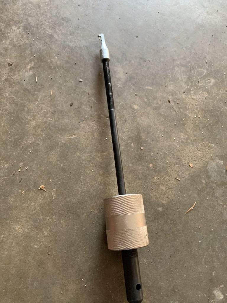

If you got to the point of removing just about everything, here's my post on the easy way to remove the fuel rails on both sides. https://www.landroverworld.org/threads/diy-timing-chain.31050/#post-190524. You'll need the injector removal tool to actually remove the injectors, just make sure the tool is seated correctly before you try to slide hammer it out.

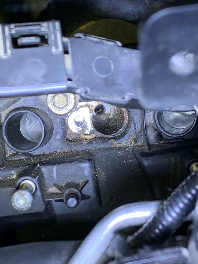

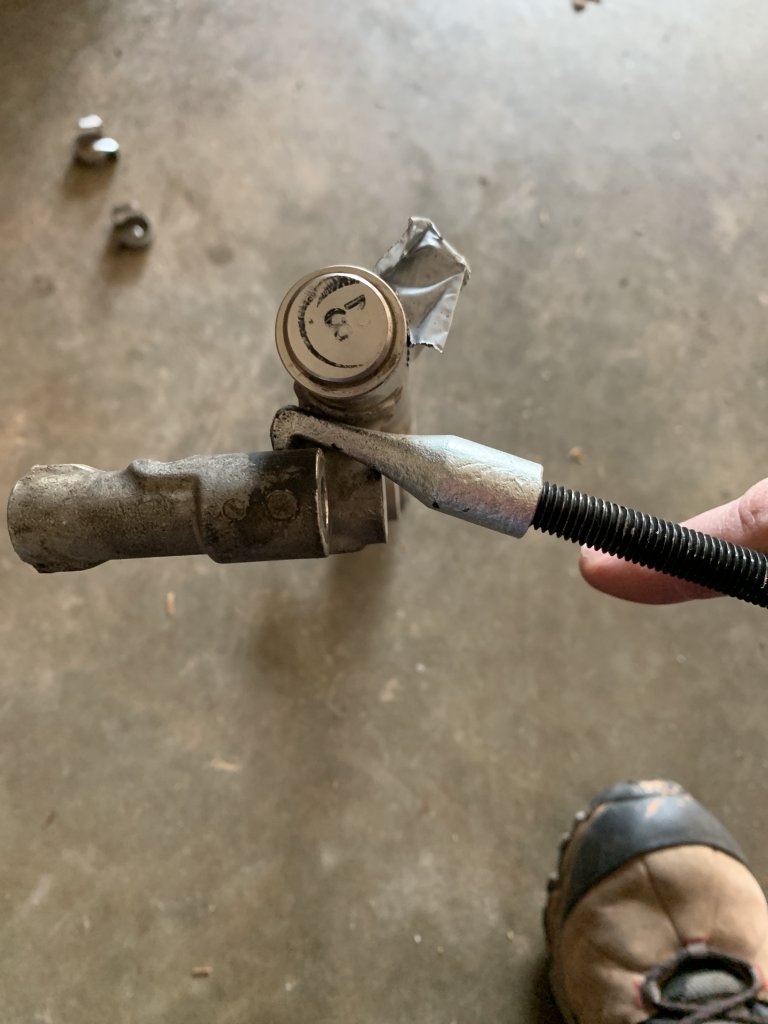

ok, so the fuel rail came off with a slide hammer from harbor freight. Took several good whacks with it but it’s off. In the 1st photo, theres enough on the transition on the rail that you can use the slide tool and lever it against the rest of the rail so it bites the edge.

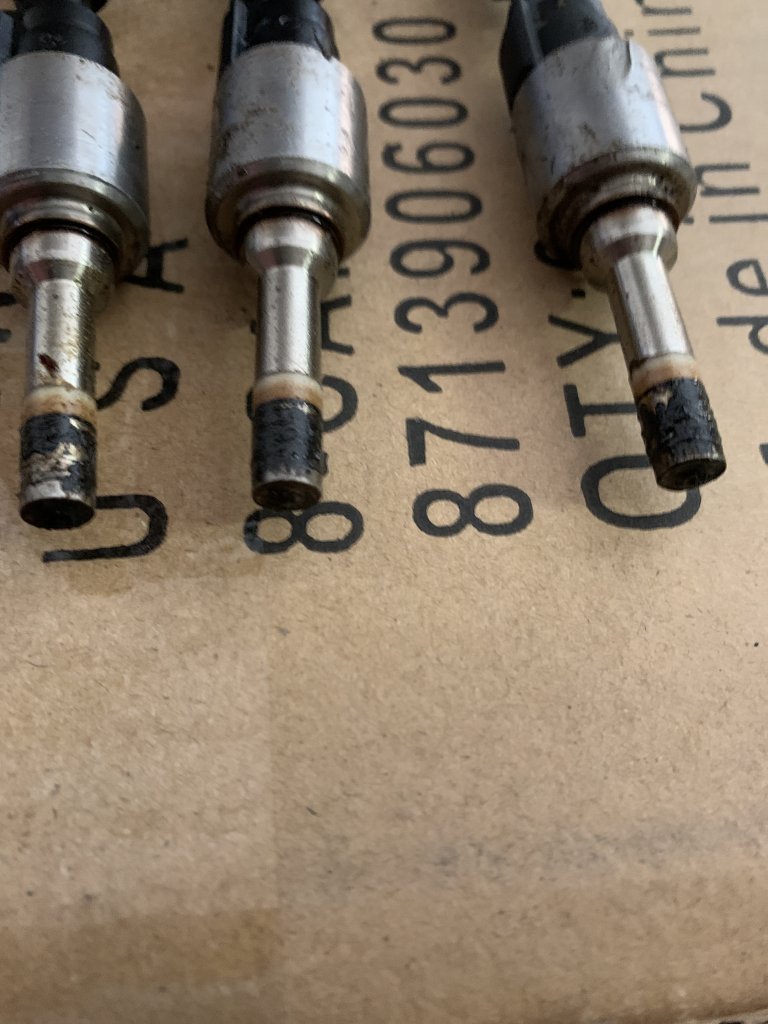

Times like this I wish I had the SC v6. This last injector on cylinder 8 (7 of 8 out) is a pain. I’ve got Seafoam penetrating petroleum oil hopefully working it’s magic. 2,4,6,8 much harder to get out because 1,3,5,7 were pulled recently (new valve cover). At least 30-40 pulls on the drivers side bank, it felt like, and lots of carbon. Was surprised I wasn’t getting misfires before last week. Will be interested to see if there’s a slight tick up in “fuel economy”

what did you do to clean your injector ports?
I have a shop vac and modded the smallest adapter with bendy straws. Similar to this, https://www.instructables.com/id/Vacuum-Straw-Brush/.

ok, so the fuel rail came off with a slide hammer from harbor freight. Took several good whacks with it but it’s off. In the 1st photo, theres enough on the transition on the rail that you can use the slide tool and lever it against the rest of the rail so it bites the edge.View attachment 10474 View attachment 10475

I am understanding this correctly? Is @scott schmerge using the Harbor Freight slide hammer to accomplish the same thing you did with your bottle jack and 2x4 rig?
@scott schmerge didn't remove his intake manifold and went the slide hammer route. Looks like it worked for him. I'm just wary about popping out one end of a fuel rail vs the entire rail at the same time. Since he's replacing his injectors it's not a big deal. Otherwise, I would check the old injectors if it bent.
