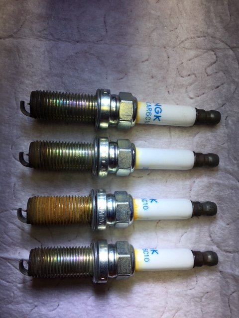

    Here are my original passenger bank plugs at 100k miles. No idea why one plug had rusty threads. Some water ingress I guess? 6C10 no longer exists. I believe it is now 7C10 as per NGK
    There is a great step by step DIY on spark plug replacement. It isn't easy as there is very limited space but if you take you time it can be done. Most shops here charge about $500 labour (Canadian) to do it. You will soon find out why. Yes NGK Iridiums are about $10 each and are the stock plug. NGK changed the plug number (superseded the original plug number.)
