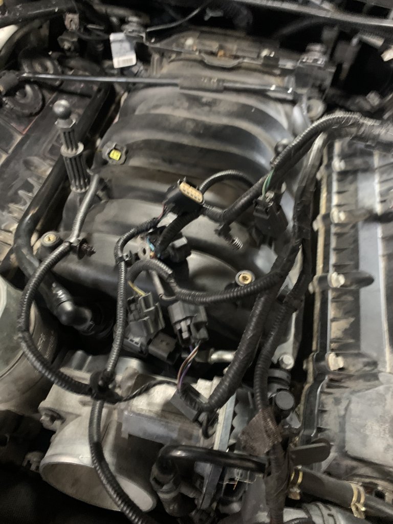

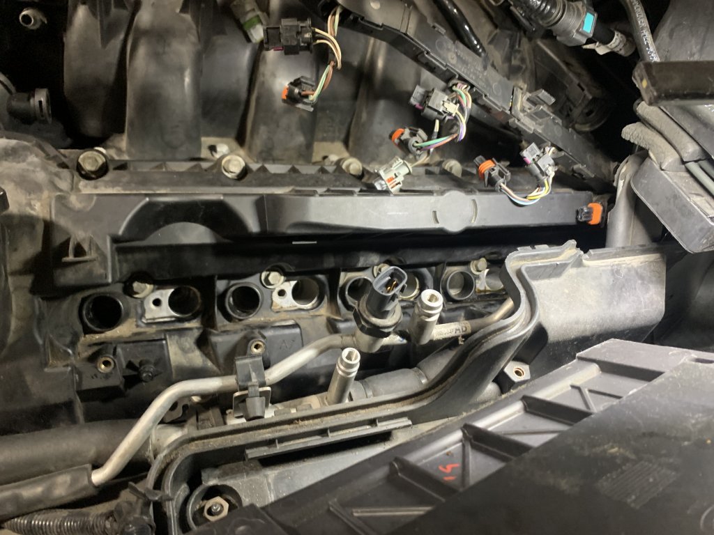

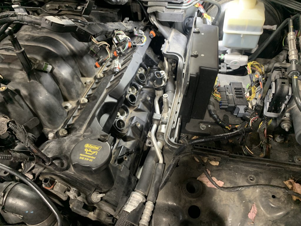

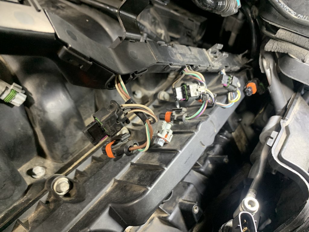

I attached a few photos to show what access was needed the trickiest process was removing the front of engine elec connectors which is essential not to damage them by pulling on the wiring loom that runs tightly across the top of the spark plugs/injectors.

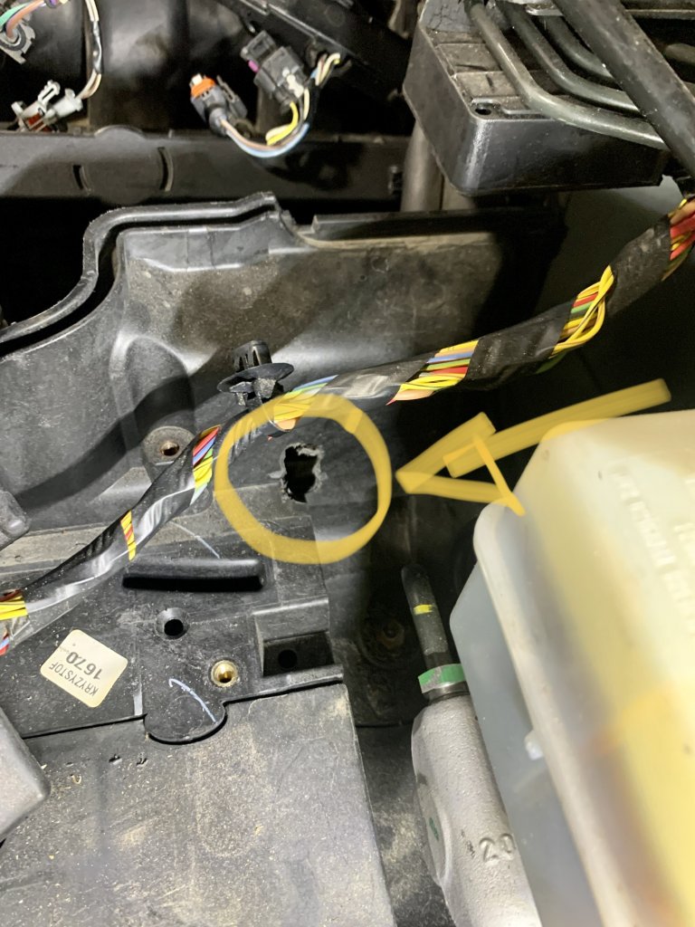

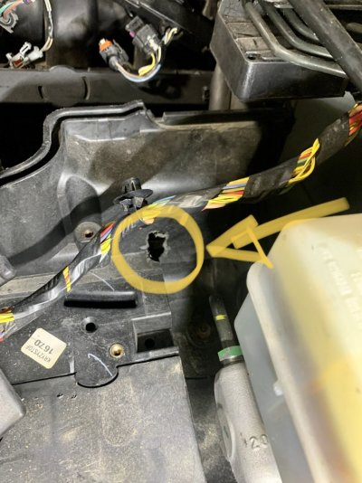

A previous owner had “drilled” an access hole for the rear spark plug coil which made it MUCH easier to access.
