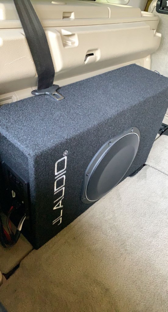

I’ve got a 400watt JL ported enclosure with a built in amp. once I got it tuned it sounds like it was meant for the car. Bass is Chrystal clear and will crank loud. sadly I got the measurements wrong so I can’t use one of the third row seats but honestly don’t really need to use it anyway. I’ll send photo when I’m home later if anyones interested.

Mine wasn’t too expensive, the sub I used went up in value due to the shortage of supply because of the ports being backed up. I originally got mine for $500 and install was around $300 making it around $800 for the whole setup. The guy simply just wired the sub input to the factory sub input. The cables for the factory sub are located behind that left removable panel in the back. For me it was worth every penny but that’s because I love crisp low bass. I ended up turning down the factory sub on the Logic 7 system which reserved wattage for the vocals so I get 0 distortion at ridiculously high volumes with the windows down. (Forgot to include this but I also placed sound deadener all over the inside of the doors and door panels myself about a year prior so I don’t get door rattle distortion) I didn’t end up buying a bass knob either, I just simply adjust the factory sub setting and that automatically adjust the settings on the JL sub as well. The only time I ever fidget with the sub setting is if I go windows down and A/C off I use a little more sub. heres A photo I have just off of my phone, I’m at work now but will take more photos later including the sound settings and the setting on the sub I use. Here’s the link to it on the JL website: https://www.jlaudio.com/products/acp110lg-tw1-car-audio-microsub-amplified-subwoofer-systems-93332

Wow that's pretty expensive though and it looks of really good quality. That is not what I was referring to when I said "big ghetto box" by the way. I meant the sub boxes wrapped in the cheap extra wooly/fuzzy black felt carpet and just sits in the middle of the trunk unbolted and bouncing around haha. That set up is actually way easier than mine as the amp is built into the box. I had to hide my huge amp behind the side cubby trim by where the tire changing apparatus is located. The one plus side for me is that the seat is usable. I regularly use all the seats in my truck.
