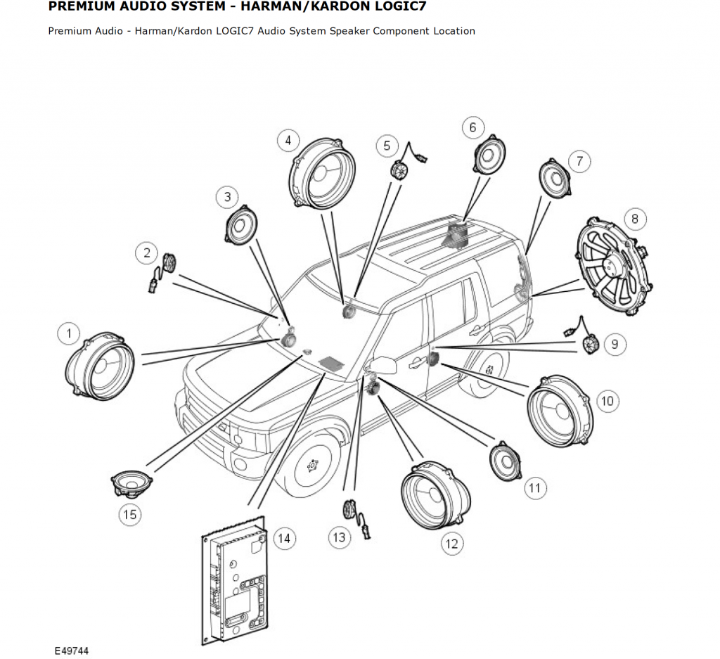

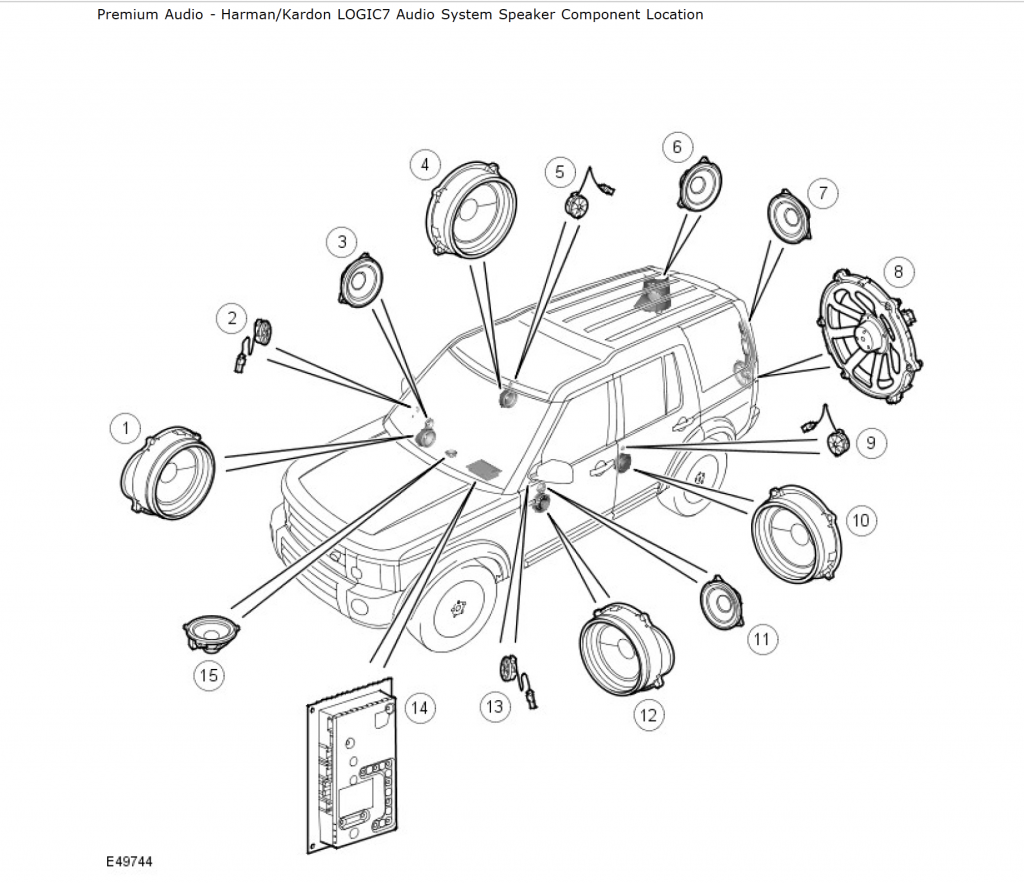

Ok one thing that’s always confused me is the fact that the Logic7 System is the fact that from 10 to-11 they had a 14 speakers, but from 12-13 they had 17 speakers instead of 14. Where did they add the extra 3 speakers after the 14 speaker Logic7 system.
Tapps33
Jul 23, 2019
418
350
Bath, Maine
As far as I can tell, the Logic7 systems only ever had 14 speakers. I'm not sure where the 17 speaker configuration came from....a RR or RRS perhaps? I've attached a screenshot from the 2010 and 2013 LR4 service manual which shows the same speaker config's across the years.
