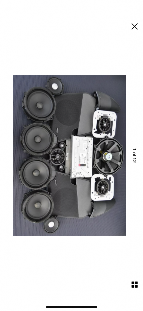

Turns out that they did indeed make the car a 17 speaker system. After looking further into the deal I figured out that the front center speaker as well as the 2 mid speakers in the cargo area were converted into tweeters plus mids. As for all the other ones due to the significance power increase you can tell that they redid all the mids, tweeters, bass, and the sub. As you can see in the pic down below it’s much different then the speakers in the 10-11 Logic7.

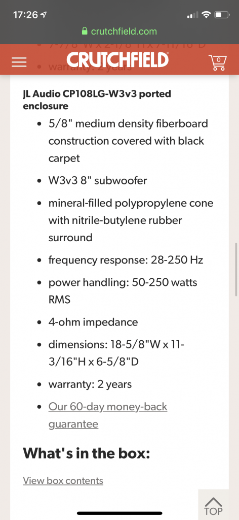

I agree. I would definitely have bought the set up and done all of it.... if I had the money to. Because I want to buy 18’ rims with 265/65/18 ridge grapplers and rock sliders plus put the oem black grills on my car to compete the black package I’m a bit short on the money to make my car a studio. The link to an aftermarket stereo system is actually a brilliant idea. If I had the money I’d but some mid speakers in the roof as well as a 1000w with 2 subs one under each of the front seats and I’d be set for life. But since I’m not that rich I’m afraid that I couldn’t do that all. My budget is pretty small at $1,000 for a sub installation. The sub package I’m Thinking of getting is a “300w bass package” Link: https://www.crutchfield.com/p_700BPKJL3/JL-Audio-300-Watt-Bass-Package.html
I

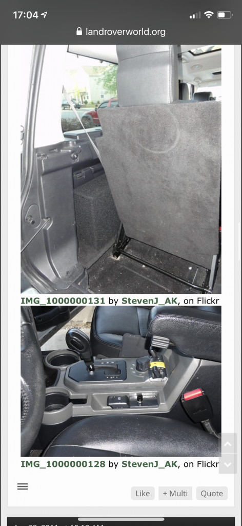

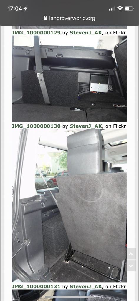

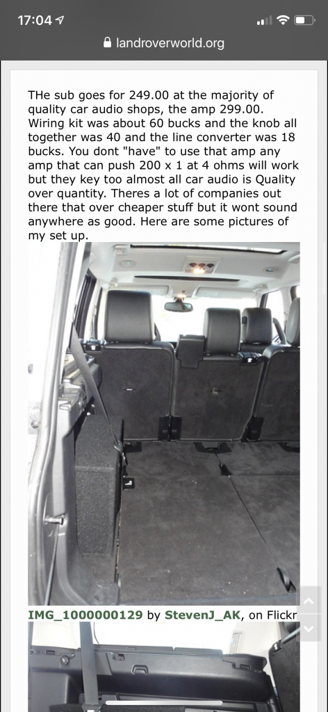

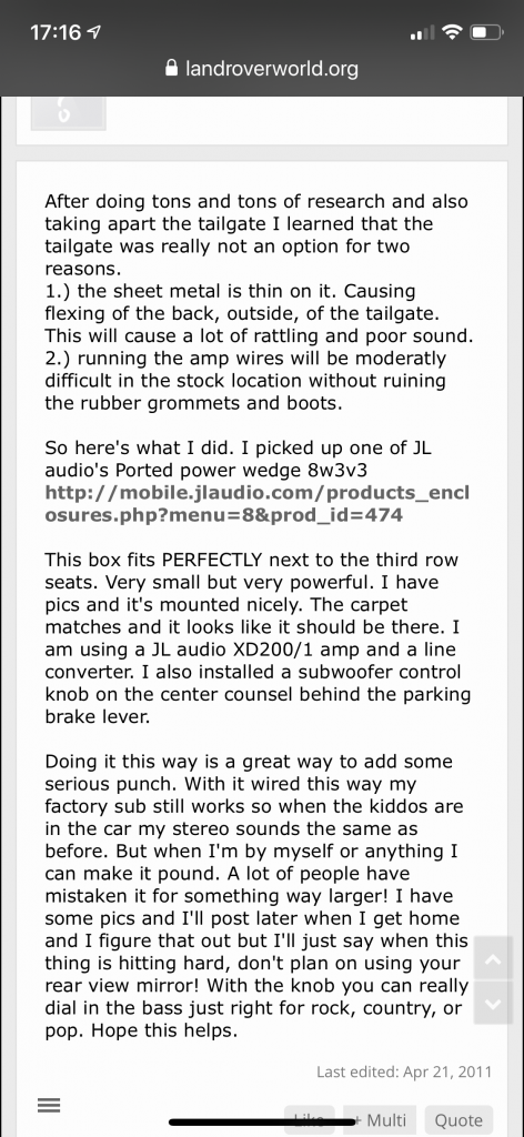

plan to Dynamite all the doors as well as route the sub to already existing sub in the back and just magnify the volume so there’s more bass in the second row as well as a little more up in the front. There was an LR3 Form where someone did this I’ll show pic of it so you can see where I’ll put it and everything. Now my only fear is that there won’t be enough bass for me. Do you think 300 watts is enough???

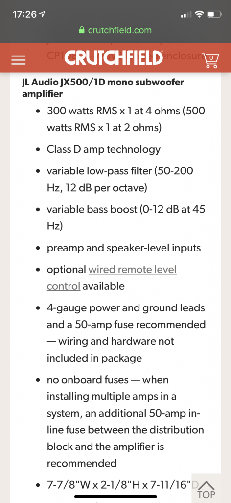

Ok, I can tell you know a lot more about matching amps to subs. So this is the point where I turn to you. I’ll send you the stats on the amp and the sub and could you tell me if you think it would or wouldn’t be a good match because I want to make sure I’m satisfied before I dump $1000 into a project that could make me as ****** as I would have been happy if it worked properly haha.
here are the pics

That setup look pretty good! I also liked the pics of the installed version. I unfortunately have too many kids and too much junk that gets thrown in the back...so even though there are some sound quality issues with the tailgate sub box, in my case I think the whole system will survive longer if it’s hidden! [emoji6]
