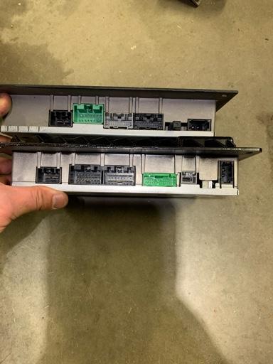

Hey guys! I know it’s been a while since we visited this thread, but I have an update I’d like to share...
To remind everyone, I’ve got a 2010 LR4 with the 400W Logic 7 system.
We were discussing an amp swap from a 12’ and up 825 watt system into the earlier year models. Well.....I bought the amp and when swapping, this is what I found:
The amp on top is the 2010 variant, and the amp on the bottom is the 2012 variant.
So, long story short, unless you’re willing to chop the harness and splice new connectors on, the different year model amps won’t directly swap. That said, I’ll have to go back in and look at the wiring diagram and see if there’s any difference in the connector pinouts aside from the shape/size.
It really sucks as I was looking forward to the power bump!
