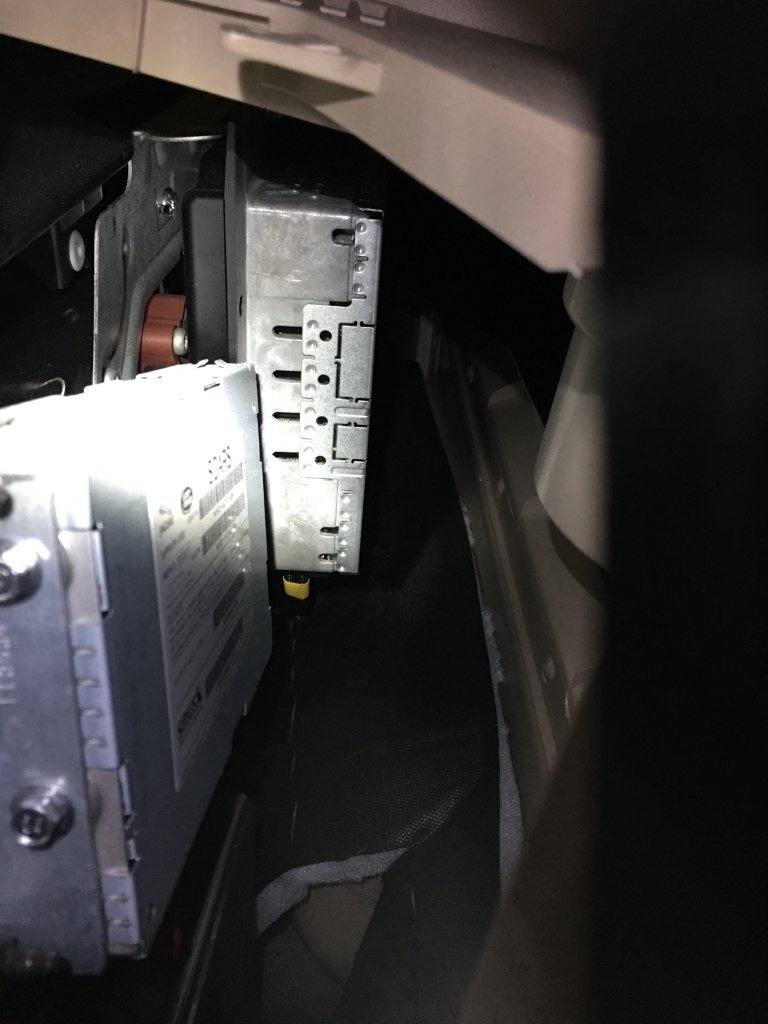

Ok one thing that’s always confused me is the fact that the Logic7 System is the fact that from 10 to-11 they had a 14 speakers, but from 12-13 they had 17 speakers instead of 14. Where did they add the extra 3 speakers after the 14 speaker Logic7 system.
I got it confirmed that the mids in the front doors are in the 2012-13. Not in the 2011s. So that is two that are there.
