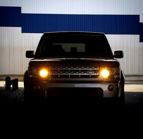

    I owned an LR3 a while back too and appreciated the looks along with the vehicle as a whole but not a fan of the under-powered V8. On this LR4 I never cared for these ridiculous LED dots that were clearly an after-thought by Land Rover's Design Team to offer a headlight that is similar to everyone else on the road at the time but to each their own. If you like them enjoy them, if you don't there is now a solution. I will probably enable Scandinavian DRL with the yellow bulbs I have installed to create a French Spec effect I have temporarily created in the image below.

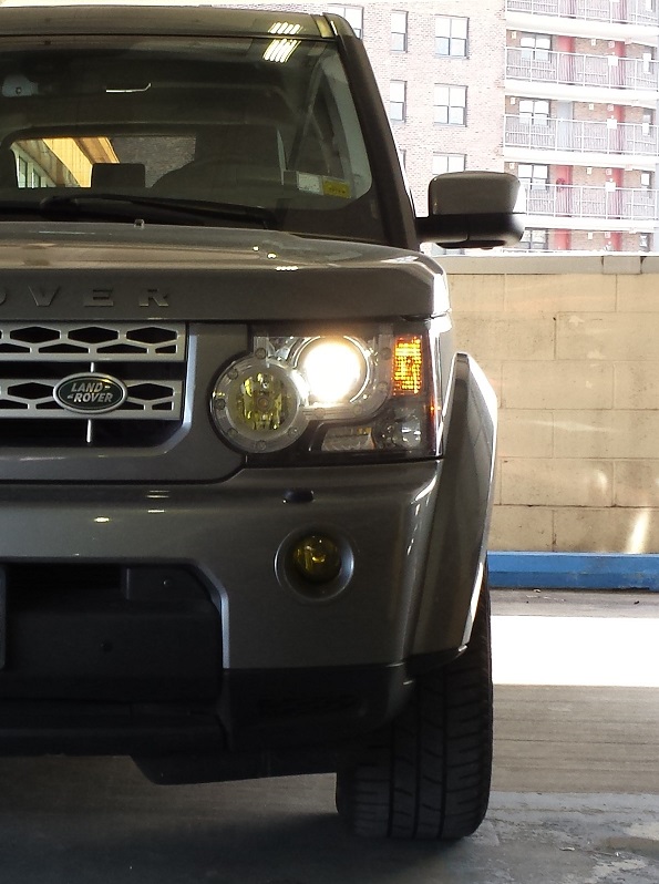

    It is very simple. If you go through the normal steps of removing the headlight as you would when replacing the bulbs you then have to remove the bracket that is held on with four (?) 7mm bolts. Once you remove that bracket you will find a round cap which gives access to the wires I photographed. You will see that there is a white plug with two wires coming out of it. Those are powering the LED only. I unplugged them and then tested before reassembling. No errors or issues. I then placed black electric tape over the contacts and tucked the female portion of the plug into the housing and covered it with tape as well despite the cap offering an adequate seal. I assembled the headlight then reinstalled and now achieved the desired effect.
