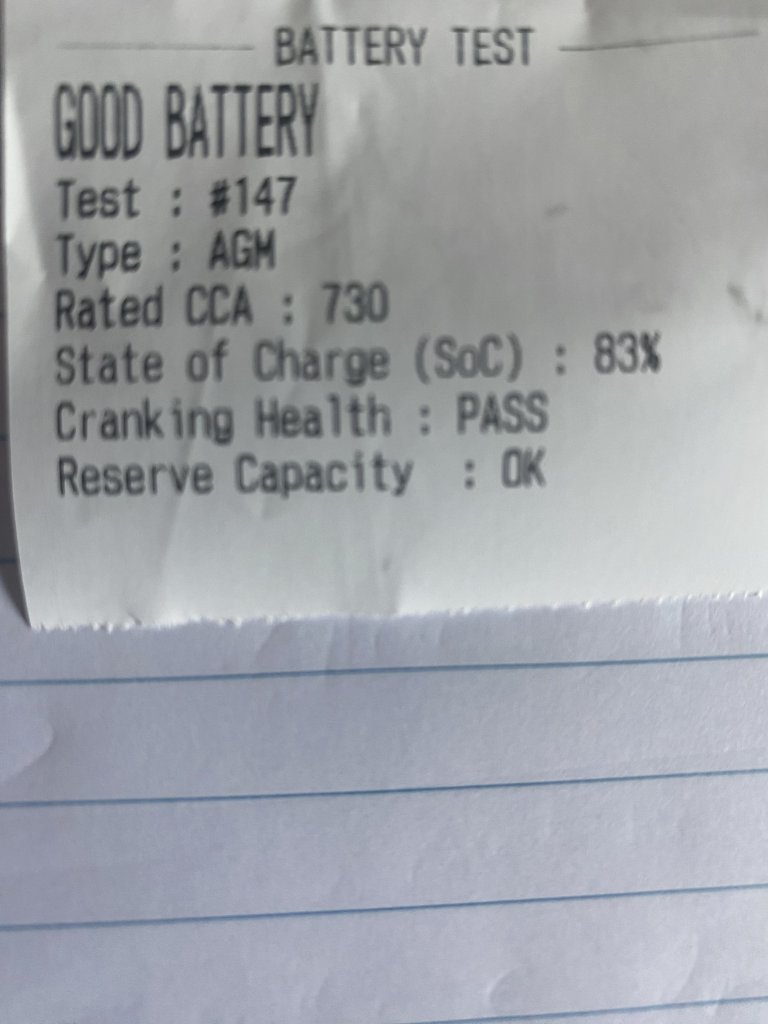

I drive the Rover on Sunday and parked it in the drive. Went to start it yesterday and all I got was a relay click. Battery reading was around 12.5 per GAP which was low IMO so I pulled it this afternoon and had it tested at AutoZone.
Tested good.

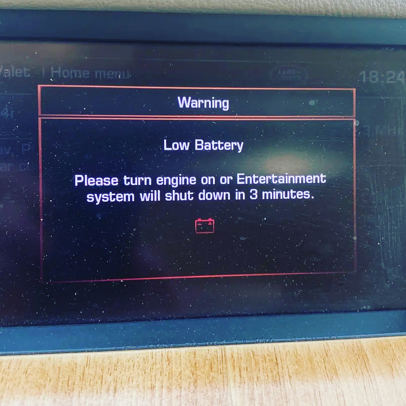

Take a look at the attached pic regarding the battery…
Longtrail
Sep 3, 2022
244
117
Ann Arbor
That battery warning I believe is normal, I've seen it before when I'm in the car; have the radio playing and the engine's not running. The car will do a lot to stop auxiliary systems from draining the battery. I'd take the advice already provided and try to add axillary power to the battery; likewise, check the ground strap.
