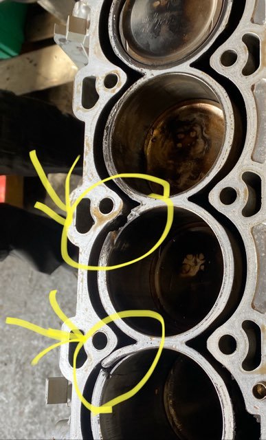

I'm going to speculate here... Given the nature of many of these cooling system issues lately, no visible leaks, I believe the engine block is the next place I'd put the blame on... poorly designed coolant routing and inadequate, porous castings. I've attached pic from one of the engines a local reman shop sent me when I was sourcing engines. This was a V8. The reman shop confirmed block casting quality is playing a huge part.
That's just my take. I only wrench for fun and by no means would consider myself an engine guy, so take it easy on me.

There was no way to definitively identify what caused the failure. The shop that did my cooling system overhaul has a pretty good reputation. When I originally picked up the vehicle, I turned on the heater to get the coolant flowing and I heard a rush / air pocket flowing through the dash. Knowing what I know, I immediately turned off the engine and went back into the shop office and told them what happened. They assure me it was vacuumed filled / proper LR procedures were followed, etc. In hind sight, I should have told them to try again.
