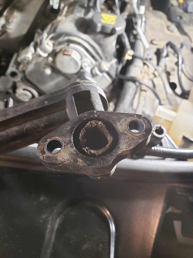

The repair is significantly more expensive (and just more of a PITA for the DIY) on the SCV6 than on the V8 because the supercharger has to come off to get to the pipes, which means draining the coolant, disconnecting a ton of tubes and sensors, etc. Even at that, $5500 is nuts. I’ve seen reports of the V8 repair costing about $1K, and the SCV6 at $2K+. Not sure if those were dealer prices or indy repair shops.
I changed mine at 52K, and the front manifold pipe was totally degraded where it meets the block. The rest of the pipe looked like brand new. Rear crossover looked fine.

Just curious: Is there any way to visually inspect for the degradation? Ie, see the problem before it goes too far?
not usually.
the rear pipe is almost impossible to see at all.
the front pipe is mostly covered by the intake manifold (or supercharger). its this portion of the pipe, that you cant see, that deteriorates from heat.
Agree with Daytona. Even if you could see the outside it would probably look fine. Mine looked fine on the outside, but was soft and breaking down from the inside out.
