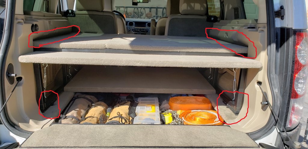

Well, I just realized I forgot one of the more important aspects to mention.
The rear load floor of these trucks is not level relative to the rest of the interior. It has a slight downward slope of about 1" from the forwardmost point of the cargo area to tailgate.
If you want your platform to sit level relative to the interior, you will need to shim the rear of the platform to account for this.
It is easiest to see where I have circled in red. Without the shims (which I have also circled) the platform will not sit level relative to the cut-outs in the cargo area side trim panels that allow the upper platform to slide forward and back.
I used hard plastic shims thus far, but I am in the process of getting some custom hardwood shims made that will allow the lower frame of the platform to bear on the shim along the entirety of its length. I have bounced around on this thing as it is, and it functions fine with the plastic shims, but I am looking to do it in what I consider a more correct manner.
Alternatively, if the look of platform not being level relative to the cargo area side trim doesn't bother you, you could account for the downward slope of the cargo area through the adjustable feet on the forward platform and still end up with a flat sleeping surface that is also at a slight downward angle.
Sorry for the oversight on my part. Now you know...
