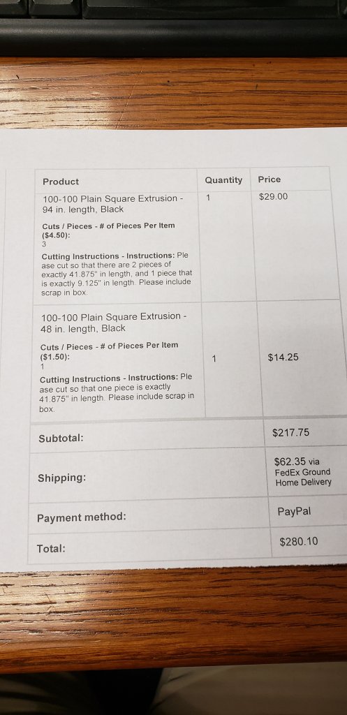

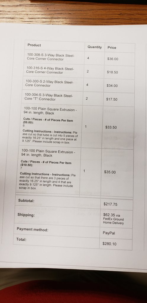

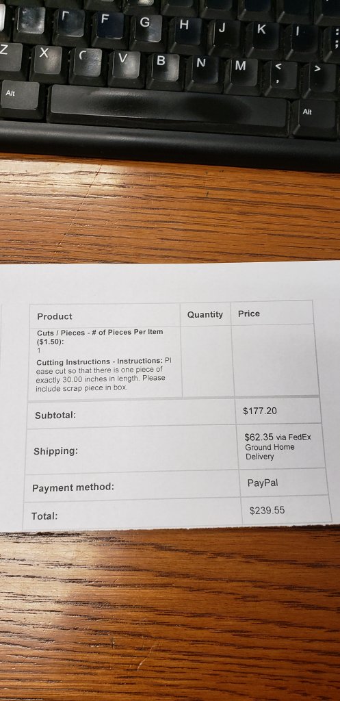

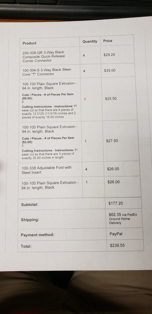

All in, I was right at a $1,000.00. That included $378.00 for the carpet and upholstery. I have never done that work before, so I paid a shop I knew would do a good job.
Below are receipt copies for my orders from EZ-Tube. Please note, that they screwed up one order and shipped the wrong color, but told me just to hold onto it and they would ship the correct color. I ended up using a good bit of that extra tube for the legs for the front platform. I would estimate about 20'. That 20' is not reflected in these receipts.
Not shown on these receipts is Carpet/upholstery, 2 additional EZ-Tube feet, piano hinge, a 4x8 sheet of birch plywood, a 2x4 sheet of birch plywood, plastic shim stock from Amazon, and several cans of spray on sealing primer (think KILZ).
The rear platform was done exactly according to the diagram Perkj posted at Expoportal. I can do some measuring when I get home, but it's going to be a week or so. If you look at the pictures in the first few posts in this thread, you can make out how the framing is done.
