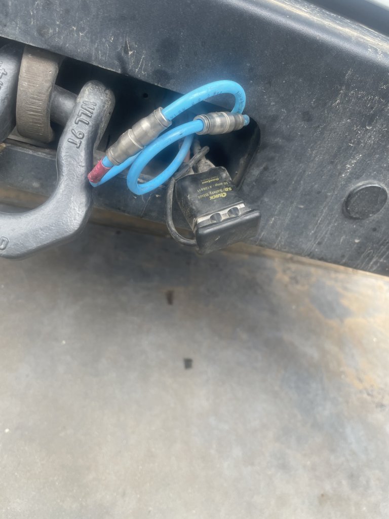

You guys are on the right track. Pictures for reference.
Pro Tip. Mark the ends of your loops on each side of the union with colored tape so you know what goes where and can reconnect it appropriately. I use Red for Right and blue for left.

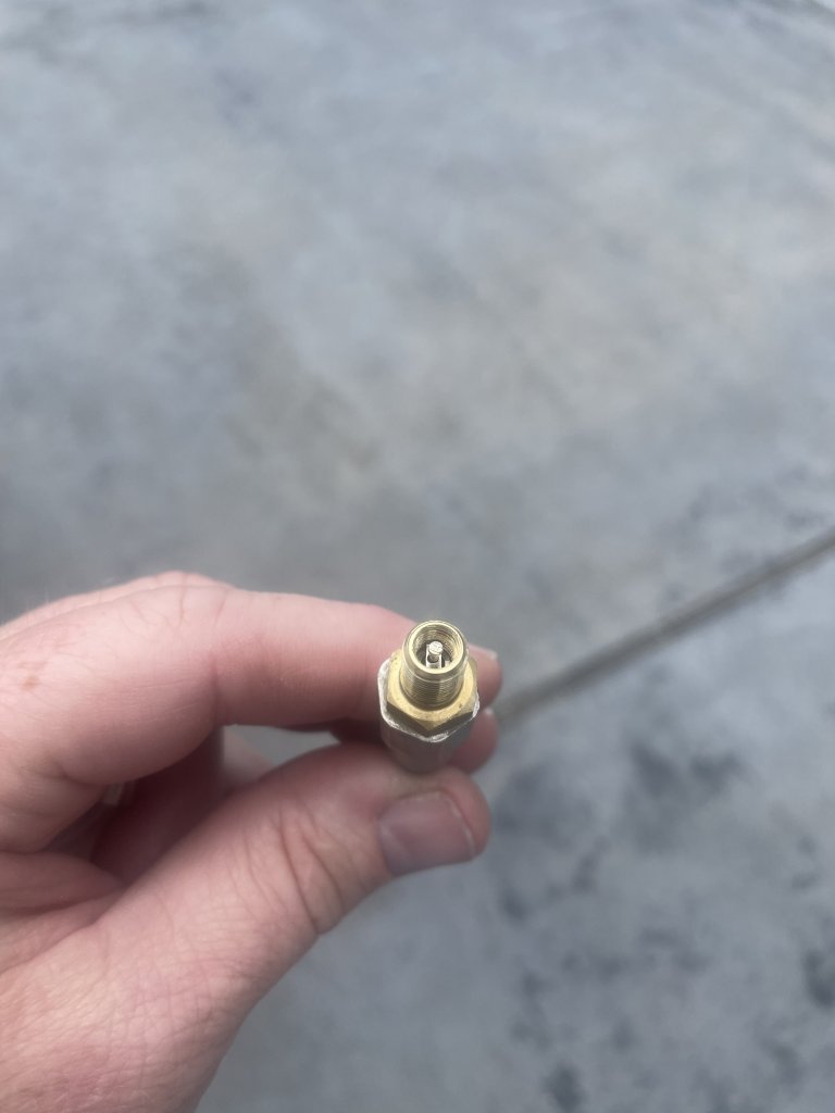

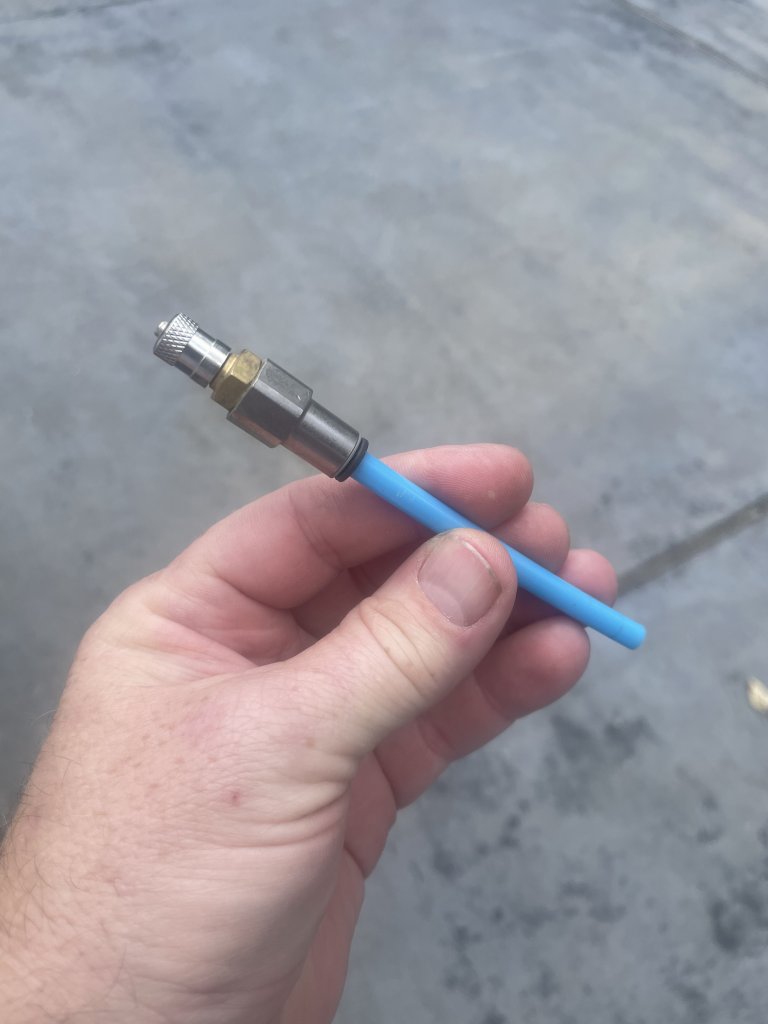

You can do this to make your own EAS bypass. This kit will simply go directly into your air strut, so make 4 of them.
6mm to 1/4 npt, 1/4 npt schrader valve, and 6mm tubing. If you're doing field repairs, you may want these 6mm unions.
So the description of the 6mm to 1/4 npt is "Female Adapter: Nickel Plated Brass, Push-to-Connect x FBSPP, For 6 mm Tube OD, 1/4 in Pipe Size", while the schrader valve is 1/4 npt. Do NPT and BSPP play nicely together?

Oh, my fault, I didn't notice that. This will definitely do it, 6mm to 1/4 npt.
