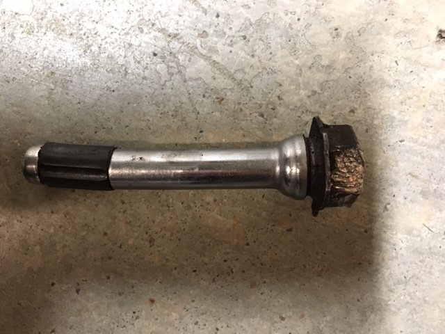

In my experience my (2010) front calipers have been very tempermental with regards to sticking. The sticking seems to relate to the bushing equipped slider pin. This pin is to designed to reduce clunking when the brakes are applied. In my experiences the bushing gets beat up and tend to jam the pin in the caliper. When doing my seasonal tire/wheel changeovers I clean and regrease my pins. For the most part this has kept the sticking at bay although this year I got lazy and in 12 months I had sticking pins again. Sticking pins will destroying a rotor quickly. I actually bent my old slider pin as I was removing it. PITA.
The grease/lube you use is also a culprit. Despite using a synthetic grease specifically saying it was safe for rubber I had some degradation of the rubber bushing. I am now trying the fancy Permatex (orange silicone / ceramic based grease) that has a melting point of a bazillion degrees. We will see how it holds up this winter.

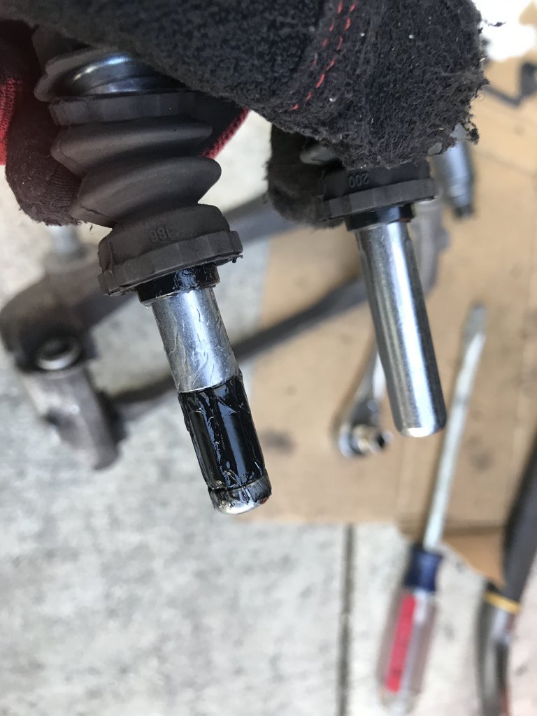

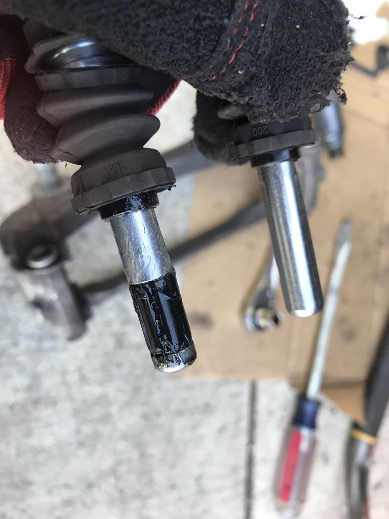

When I recently changed my pads and rotors on my 2015, I noticed the pins were not the same. One pin has a "plastic sleeve / bushing" if you will, the other does not. I put them back as I found them. Could re-installing pins in the wrong location have an adverse affect? Shooting darts here...

Could be the pins, could be the grease. Maybe order an after market caliper rebuild kit and update the pins. I rebuilt my calipers at 65k and the new slide pins are all metal and same size. No issues after 33k miles on them.

I'd start by figuring out if the sticking is in the form of the caliper not sliding on the pins or is the actual caliper piston sticking. Brake pad wear and rotor discoloration from heat should tell the story. Worst case, maybe it's a good excuse to swap to fixed brembos from an rrs:)

^^Clear grease good. Likely silicone based

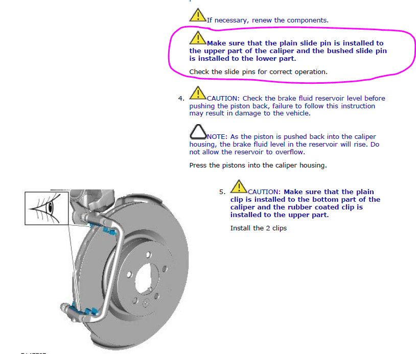

As for pins. Yes one should have a rubber bushing and it does matter where they are installed. If the latest ones give me issues I will likely switch to all metal and forget the bushing.
From the service manual:
