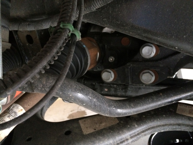

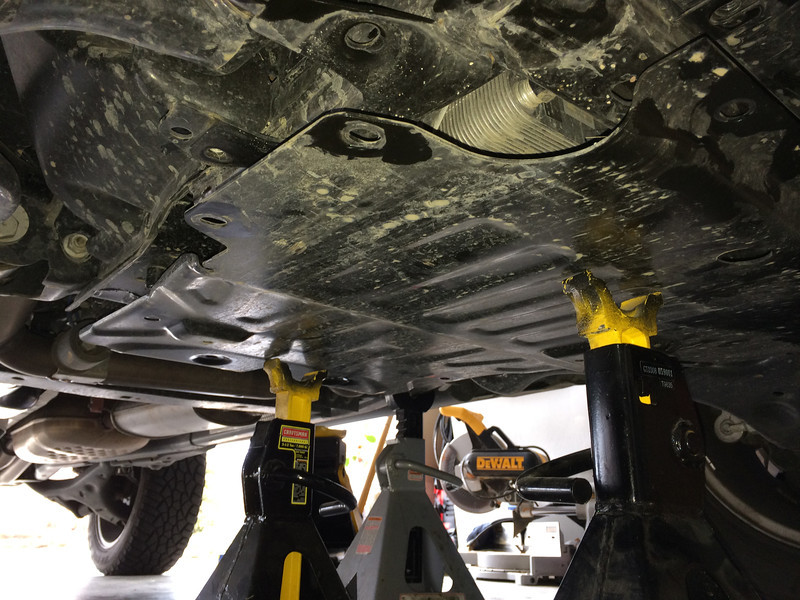

The front diff is the biggest pain the ass compared to the others because you need to take the front skid plate off.

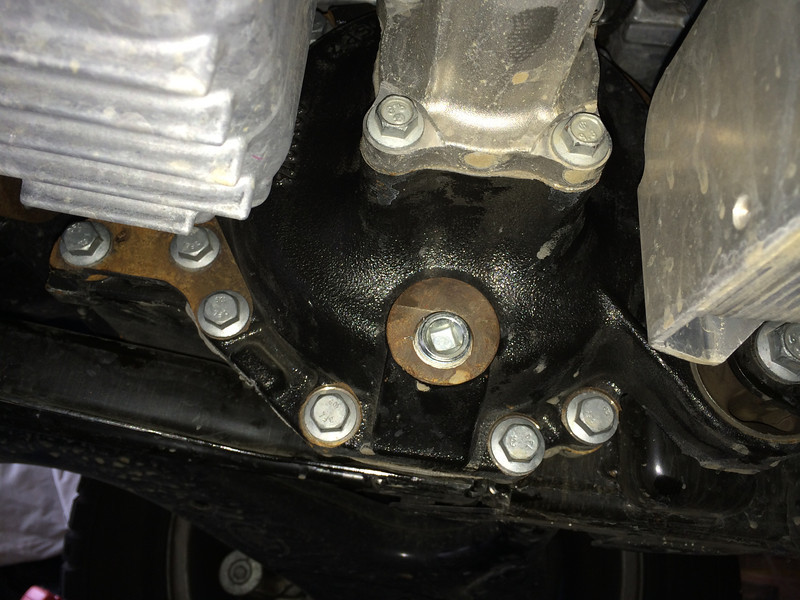

The drain hole is front and center once the plate is removed.

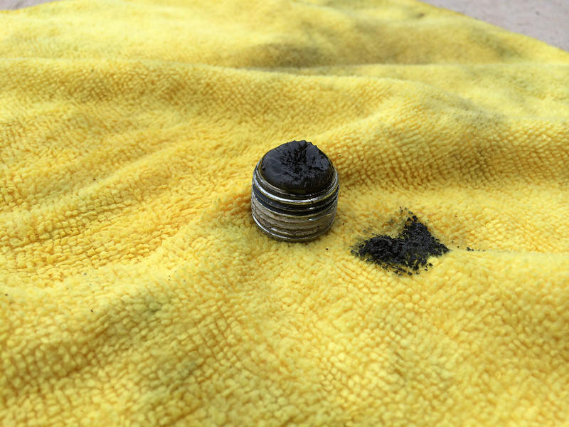

I found the same gunk on the front drain plug.
To get the best access to the fill hole I removed the drivers front wheel. It made it much easier to fill the diff.
It took just under 1 litter.
