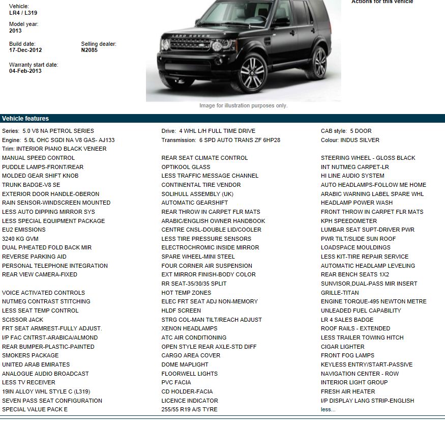

I know for sure it was disabled in the system, but I havent removed the stock tires from the stock wheels (nor do I plan to) to check for physical sensors. The only thing I can think of is that in this region (mid east) its common to air down the tires for running in the desert. Maybe they disable TPMS to avoid customer complaints on perfectly functioning LRs. Who knows, really?
Should be fairly easy to tell: If the valve stems (not the dust caps) mounted on the wheels are made of metal, you have the sensors installed but the system apparently disabled. If the stems are made of plastic / rubber, you have regular valves, no sensors (and no TPMS) at all.
If TPMS is not mandatory in your country - it is here in the US - I am guessing Land Rover didn't put any TPMS related hardware in your car.

I was just screwing around on the LR Topix website and pulled up my LR4 info and found that it says "LESS TIRE PRESSURE SENSORS" (middle column, 10th line down). I guess the Gulf country vehicles dont come with TPMS. Learn something new every day!
