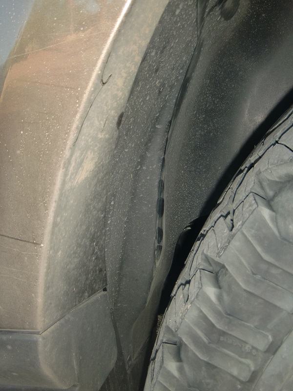

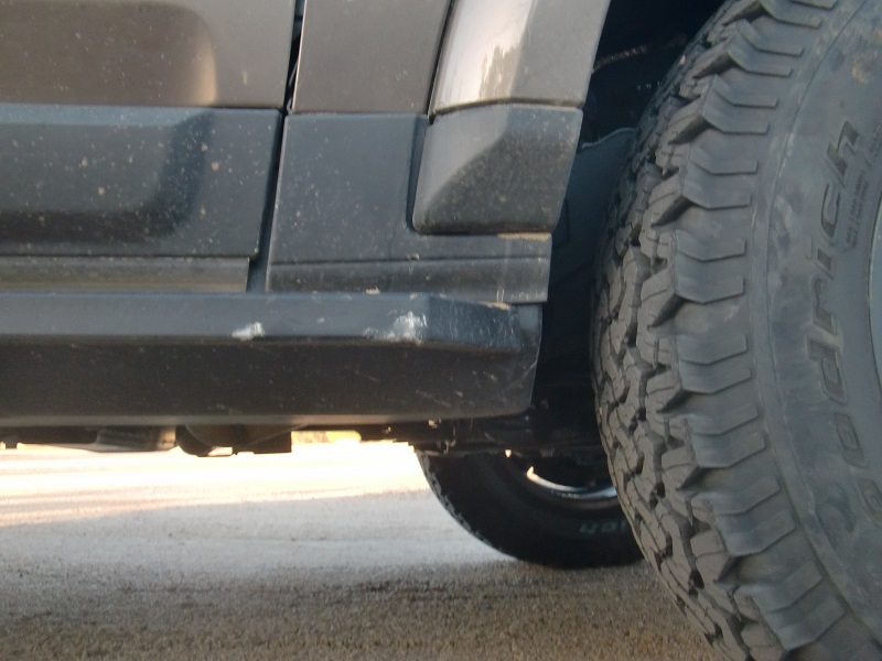

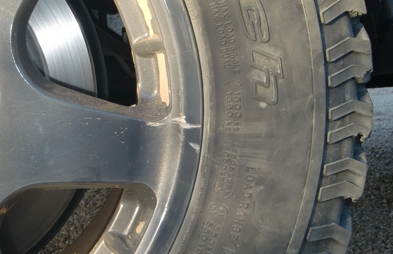

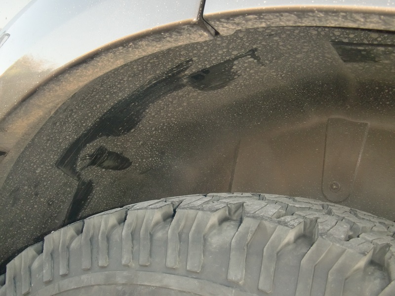

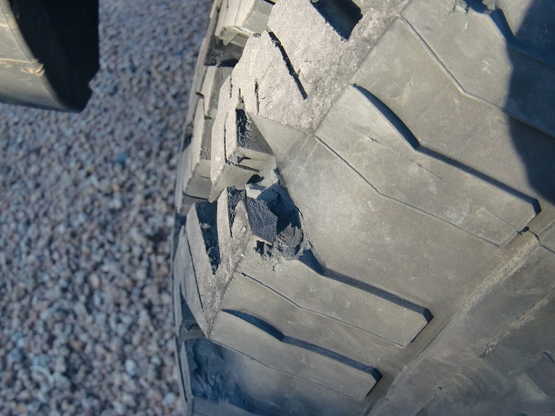

Hi David,
I will post some info regarding my experience with my wheel / tires at the end of this week.
Still waiting for some pictures my friends took during my last two trips. ( Broken Arrow and Crown King)
I love the tires.
I run 42/48 PSI cold ( F/R) on the street.
In Sedona I did not air down at all ( lots of traction on smooth dry rocks).
On my last trail ( Crown King) I aired down to 35 PSI ( hot ) and it smoothed the ride over the rocks.
Rubbing- yes it is present in the back. Nothing serious.
Rocks ate some of my tires and I found my rock sliders helpful.
My PD1880 got some minor damage too.
It looks like my thread will be long . I may have some time on Thursday to seat down and post something.
Just few pictures today. More to come.

Thanks for posting this, can't wait for more photos. Wow, you did some serious rock climbing to get that damage! Though, I know in that terrain it's tough to avoid. So, you were running in off road height for most of the time? The rubbing does not look too bad at all, and likely can be avoided if you get LLAMS/IID Tool later on for off roading.
