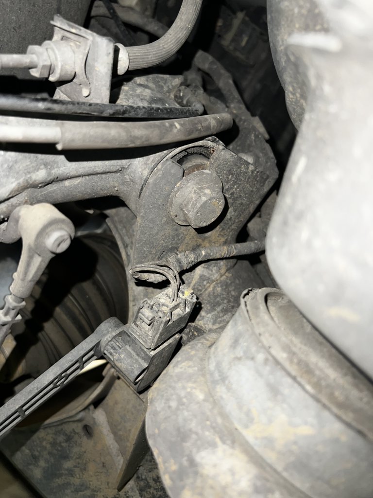

unfortunately i come here barring some bad news (for me). noticed my rear passenger side tire wearing a little bit more on the outside and thought the people who did my alignment didn't do it right, come to find out that my rear passenger upper control arm is busted, not even the liquid filled bushing. has anyone replaced these themselves? are they a pain?
ugmw177
May 25, 2023
118
73
Charlotte NC
Yes, rear uppers are certainly doable in your home garage; easier than front lowers, in fact. Still need 4 wheel alignment afterwards. Also whatever alignment shop you use make sure they [or you] set vehicle in tigh tolerance mode just prior to alignment and back to "customer mode" just afterwards.
