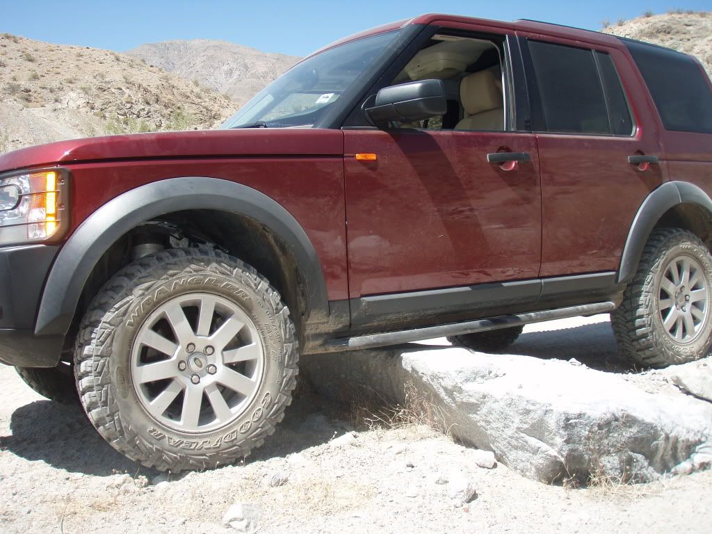

Height matters if you want to get larger tires. The ones shown here are 275-65-18 and are 32 inches. I would not accept the loss of articulation room and try to run this without a rod lift as you encounter problems. Increase the height and you will be much better off than forcing the tire.http://johnsonrods.com
