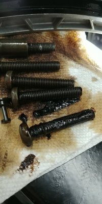

This much tar buildup is concerning. The other day saw royal purple oil use on bmw engine before and after video of open engine showe lots of gunk cleaned up by royal purple.
Do we need some thing like that oil every now and then with high detergent to keep engine cleaner?

Castrol EDGE EP 5w20 @ 8K for the past 3 year of ownership.
Got the car with 85K, so guessing the damage was already done.
The thing is, I just did an oil change less than 1K ago and the oil looks dark. Don't think I'm overheating.
I saw that video pop up on my YouTube. Looked pretty convincing.

ignorance is bliss man! Why’d you have to go and show us that? Lol. I like thinking my 5k oil changes keep things from looking that way in there...now I’m not gonna sleep
LOL.
Keep digging myself deeper. Stripped the head on one of those sprocket bolts and tore one of the filter on top of it all. Dealer wants $14 per bolt and $40 per filter.
Two months after starting this "project", I'm still chasing parts.

Look at all that tar.
Eek... Mine was like that too. I just cleaned it with brake cleaner and put it back in after I finished my beer.
