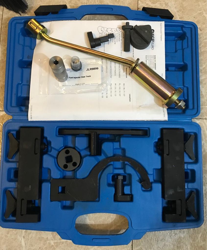

Does anyone near Denver, CO have the tools I could rent from you? If anyone is willing to ship them that would be awesome too. Would also potentially buy them from any of you guys done with the job. Much appreciated

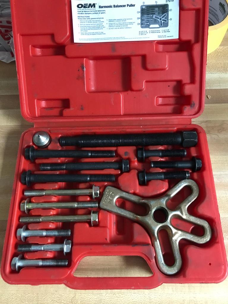

Is this the crank damper puller you guys are using?

This is everything I’ve bought to have on hand for future service.
- engine timing tool kit
- fuel pump timing tool
- fuel injector slide hammer
- fuel injector seal calibrator
Is it possible to remove/install the crank bolt in park w/ parking brake + flywheel locking pin?
