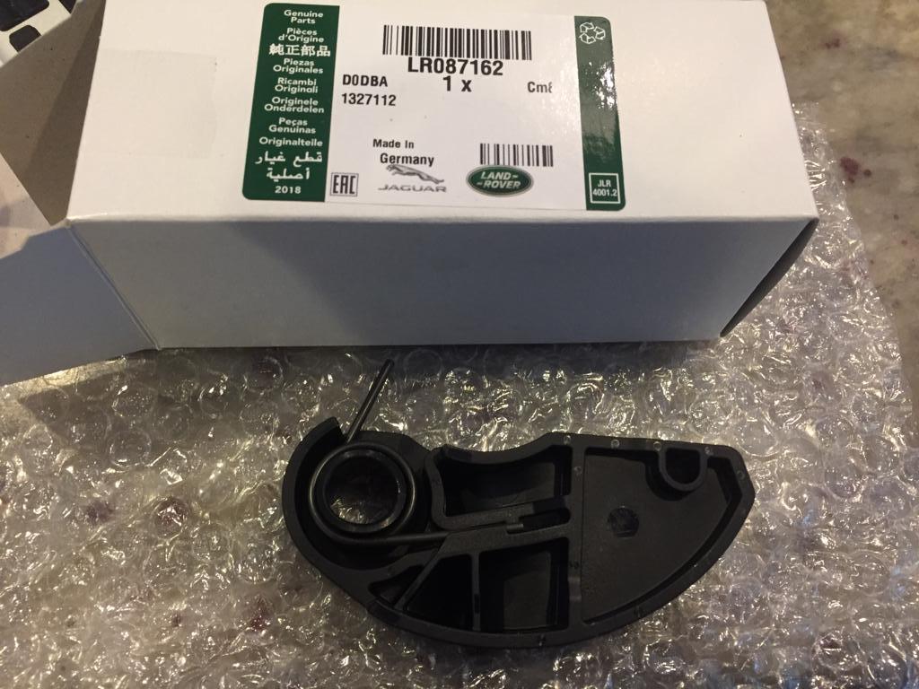

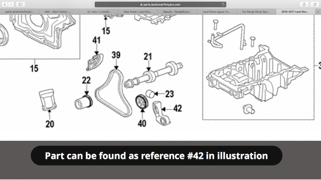

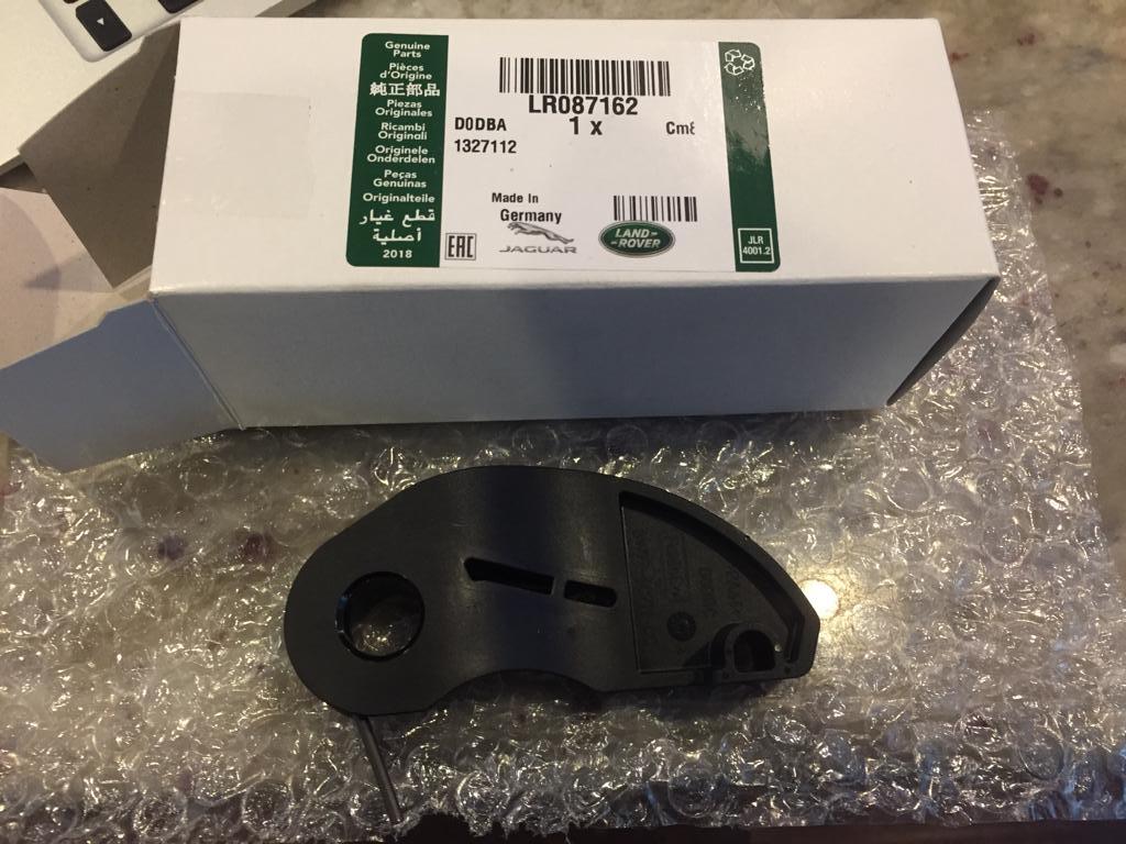

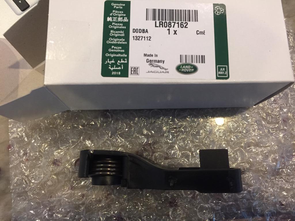

I thought I had ordered: "Chain Tensioner" LR051008. I actually ordered the above LR087162 Chain Tensioner because the part was automatically changed in the cart. Original Chain Tensioner shows as not fitting my L322 5.0. Wondering if the tensioners have been replaced again by Land Rover? Will call parts office on Monday, but could use some help.
Pictures attached, guidance appreciated.

Looks like I just screwed-up and purchased the wrong tensioner parts accidentally. Odd that the Land Rover parts site says the LR051008 Chain Tensioners do not fit? I just ordered them as well from FT Myers Jaguar Land Rover:
Part Number Part Name Price Quantity Total
LR051008 Chain Tensioner $110.98 2 $221.96
LR051008 is in the LR parts schematic as #20, though you cannot see it unless you click tick to magnify the schematic.
Subtotal: $221.96
Estimated Shipping: $13.59
Total: $235.55
I might replace the other part number LR087162 (pictured) as well if it is not too difficult since I have them.

Yeah thats for the lower chain, not the ones you care about :)
