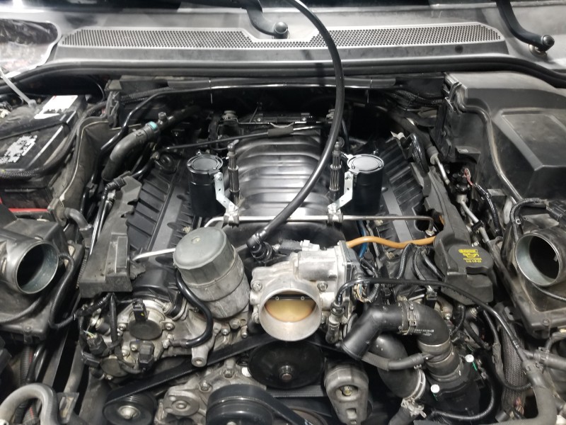

Another update... I got most of it back together. I'm mocking up oil catch cans for both bank 1 and 2, and I found the perfect spot for them. If you know, both bank 1 and 2 have built in oil separators in the valve covers, but they suck. Oil still gets into the intake manifold and gums up everything.
Debating if I should mold plastic nylon tubing, similar to the oem air tubes, or just switch to silicone.
Since I already bought the oil catch cans, I'm sticking with it. If you're doing this piece and mounting them where I mounted mine, then you should get the ones that have the inlet and outlet 180* from each other. Mine are probably 30* and isn't ideal. I was going to mount them somewhere else, but that didn't work. So, take it from me...

Awesome! So glad to see you are taking the battle against blow-by and carbon buildup all the way! I also run AMSOIL because it is the lowest volatility (NOACK) oil I have been able find.
Rubber or silicone hose is probably fine for the catch cans since you have a naturally aspirated engine. If money is not a huge issue, I would recommend steel-braided lines with AN fittings. I used copper lines on my supercharged 3.6 liter V6 (Rubicon) because the vacuum would crush-down the lines under boost.
Location looks cool though it does help the keep the catch can(s) in the coolest area of the engine bay; it seems to allow the oil to condense better. I get that space is at a premium.

Looks good djkaosone. That's exactly what I want to do with the catch cans after I blast the valves. I was even considering a single can mounted to the firewall. But not sure if the added pipe length would have any detrimental impact.
I noticed the passenger side line had considerably more oil in it than the driver side.
