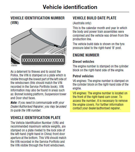

I'm not sure where that PDF is from, but it does not show the 5.0L engine, which is what the OP mentioned in his example of a 2012 LR4.
I did find something in the LR4 FSM, screen shot attached. Copy/paste for the 5.0L engine:
"V8 engines [5.0L]: The engine number is located on the front of the right-hand cam cover. To access the number, it is necessary to remove the engine covers."​
