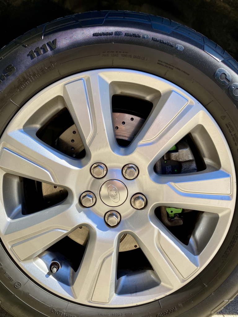

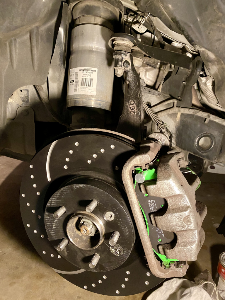

I just installed the EBC drilled and slotted Rotors and GreeStuff 6000 brake pads.
I heard concerns about being noisy over the factory rotors. I hardly hear ANY difference driving in my neighborhood where the braking sound reflects off the parked cars (windows down). With the windows up, I don't hear anything at all. I wonder if some people are installing these rotors wrongly and maybe that causes more noise? The rotor, which is marked "L" will go on the driver side. The end of the slot should be pointed towards the rear of the SUV.
It feels the braking has improved, but I don't have any data, and I'm comparing against old factory pads and rotors.
Hope this is helpful.

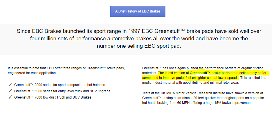

Interesting. From EBC itself doesn't sound like the greenstuff is a good match for the heavy pig that is the LR4
