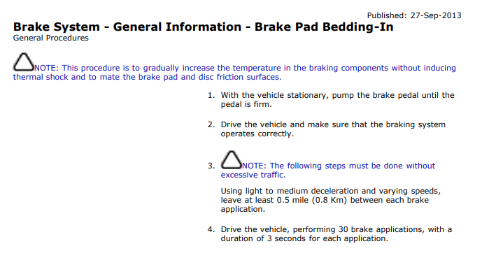

I would follow the recommendation from the pad manufacturer, for the specific pad compound you just installed.
Thanks, my latest front setup is OEM rotors and pads. I will be more diligent and intentional about the bedding process next time. I have to admit that I was so overjoyed by the lack of noise that nothing else seemed important, lol. Of course who knows, by skipping the bedding process I may have just invited early-onset squeaking.
1,420

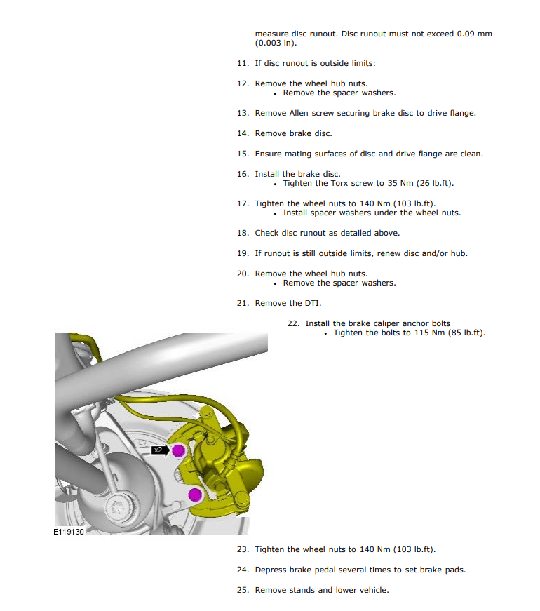

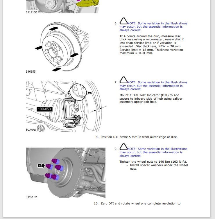

Here is LRs recommendation I assume with OEM parts.

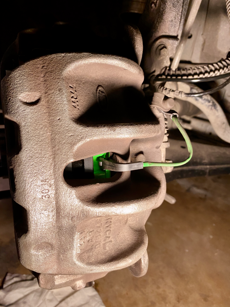

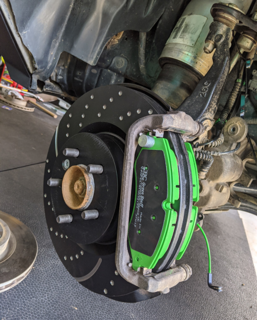

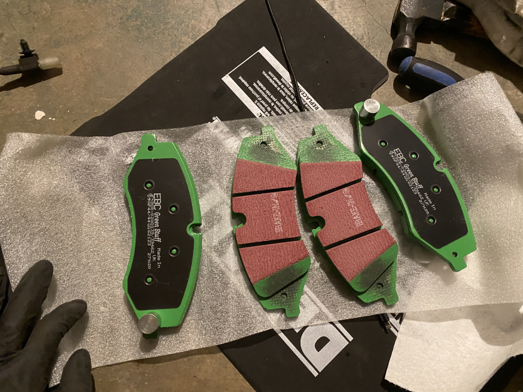

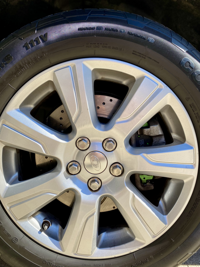

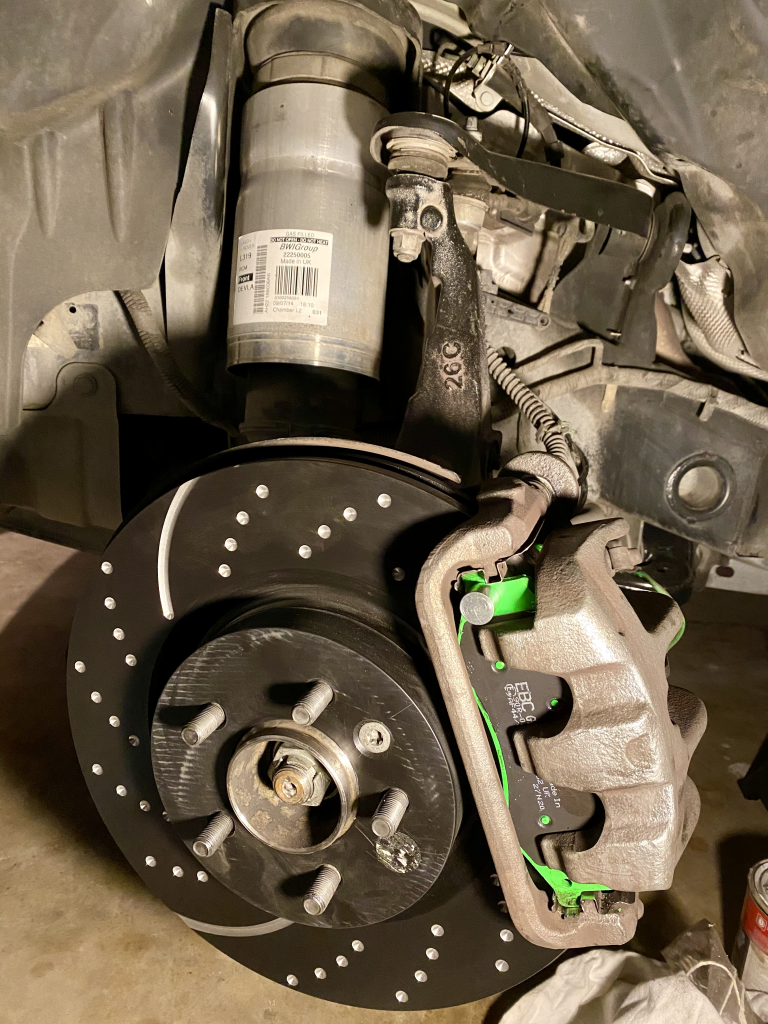

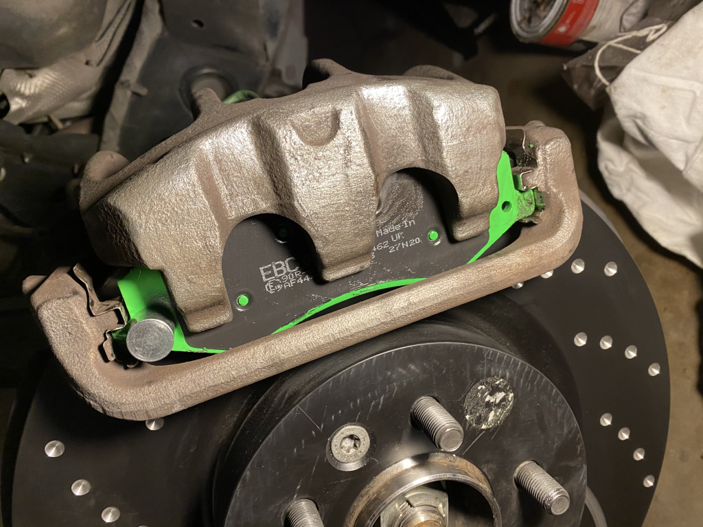

I just installed the EBC drilled and slotted Rotors and GreeStuff 6000 brake pads.
I heard concerns about being noisy over the factory rotors. I hardly hear ANY difference driving in my neighborhood where the braking sound reflects off the parked cars (windows down). With the windows up, I don't hear anything at all. I wonder if some people are installing these rotors wrongly and maybe that causes more noise? The rotor, which is marked "L" will go on the driver side. The end of the slot should be pointed towards the rear of the SUV.
It feels the braking has improved, but I don't have any data, and I'm comparing against old factory pads and rotors.
Hope this is helpful.
I have the same setup. I like them a lot but when off-roading they'll squeal pretty good when exposed to water crossings and mud. More so than the stock setup. I ended up cleaning them real good and smothered that blue anti noise paste from liquimoli on the pads before my latest trip to the mountains and seemed much better...but then again I started to notice the squeak of a bad sway bar bushing. Always something, hahaha

Above posting GreenStuff 6000 making more noise plus they can squeal convinced me to get Akebono pads.
Had "organic" pads once that squealed crazy loud attracting attention ******* off wifey ending up her parking the LR. Yup that bad and embarrassing. Lightly sanding rotor surfaces lasted two days at best then squealing again.
