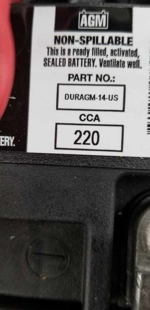

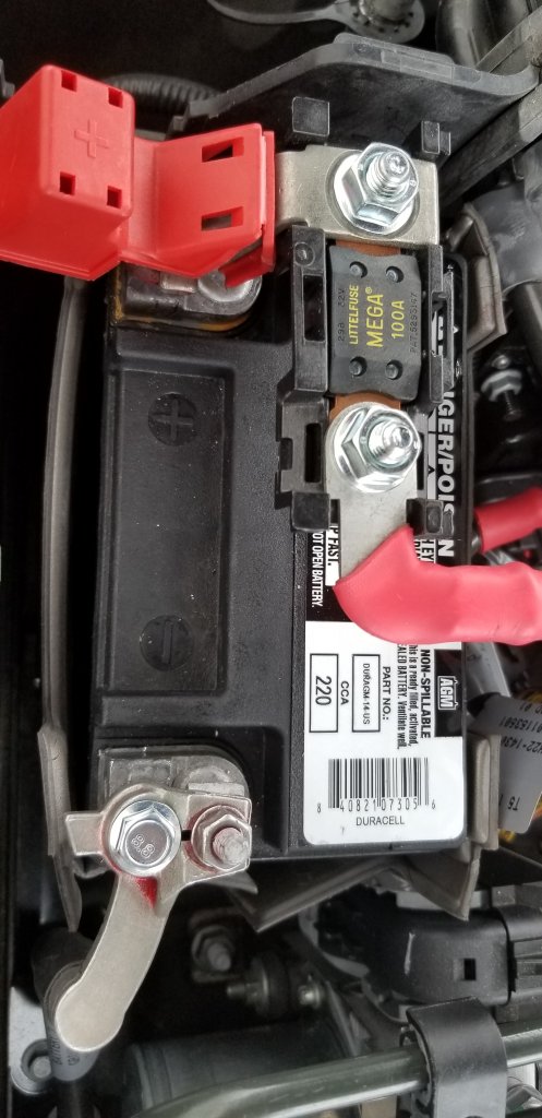

So after looking everywhere on line...after quotes from $374.00 to $450.00 for the exact JLR start battery by Exide, i found an AGM motorcycle battery, 12 vdc, 14 ah, 220 cca, which fits, not oerfectly, but adequately. I had to modify the retaining bracket, and machine some post adaptors, but it works great. Used the icar tool to reset the battery change option, and the message is gone, and eco mode working again.
I am getting a bunch of post adaptor with screw sets made, about $10.00 a set. If anyone needs a set, let me know.

What did you pay for the battery? I think I might be interested in doing this.

Digging this up as my start/stop battery has kicked the bucket. Did you have any of those post adaptor sets left?
