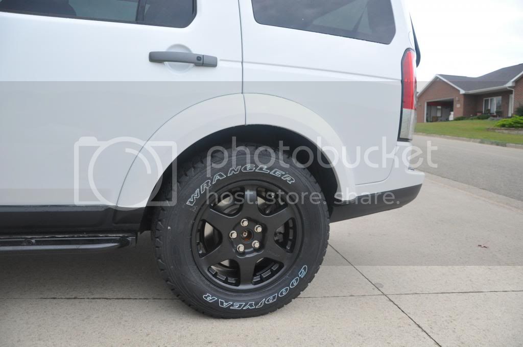

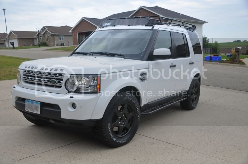

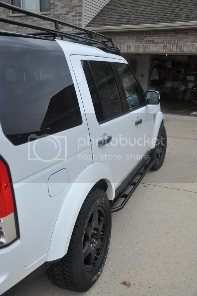

I know Finlay I've seen pics of your compo's. Does anyone else have pics of them mounted?

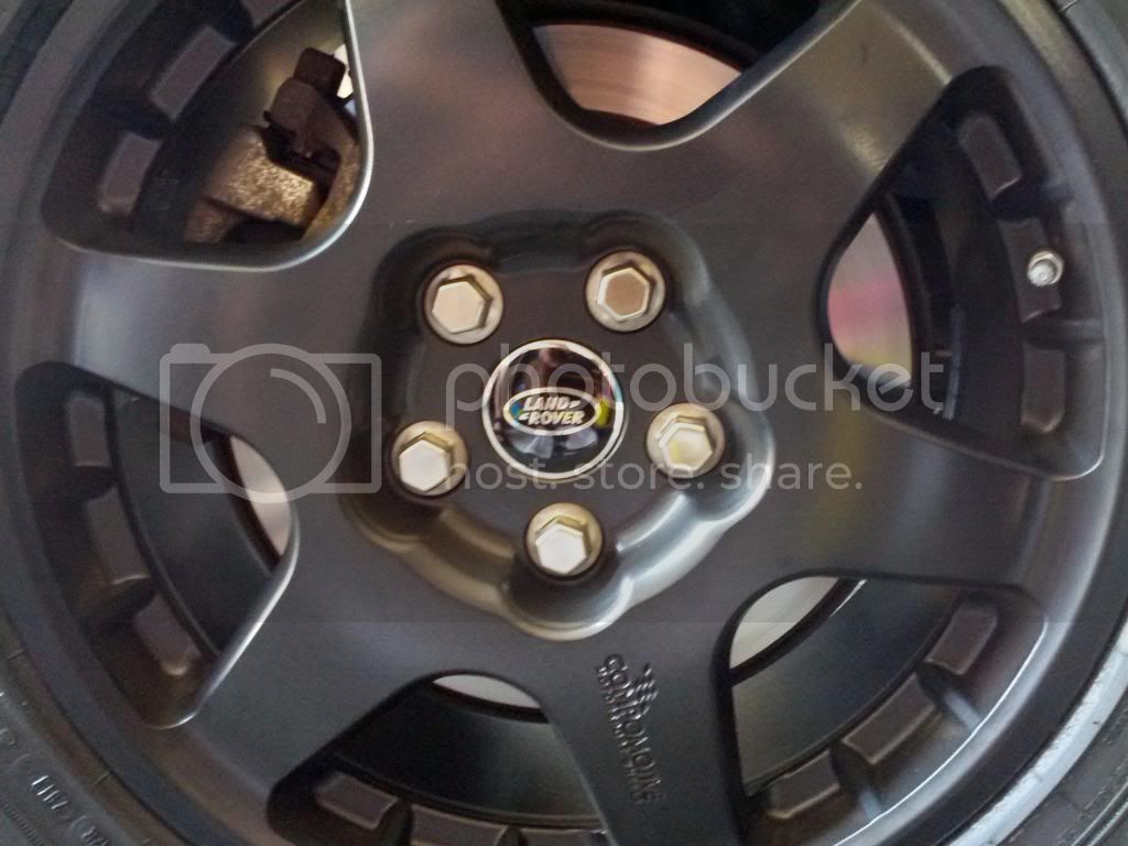

center caps

Thanks guys. Umber, you are 265 as well? the 275 is tantalizing, just for the option of another mud terrain. :stupid: I think I have a tire fetish.
