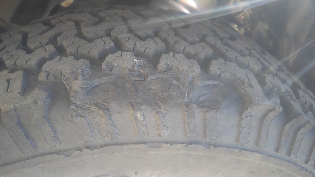

I have had my BFG TA KO ( 1st generation) for 34,000 miles (city , highway and heavy off-road use)
Lots of rock climbing and trails with sharp rocks and boulders. ( my skid plates and rock sliders were put to work multiple times. )
The tread depth is still fine but I am missing chunks of tread, and balancing the tires becomes slowly an issue. I have some cuts in sidewalls but never got a puncture.
My natural choice would be to go with a new BFG TA KO2 265/65/18 since it is E rated. There is 285/60/18 D rated TA KO2 but considering my environment I am not sure if this would be a good choice. ( I would like wider tire appearance for sure). Now, would you recommend a tire you run Nitto Terra G2 over BFG TA KO2? Why did you go with G2 and not with TA KO2 ?
Just for a look 285 would be nice but how the sidewalls strength compare on Nitto and BFG ? Even being located in Phoenix Arizona my LR4 still sees some snow or freezing temp. when we go up north. what do you think?
