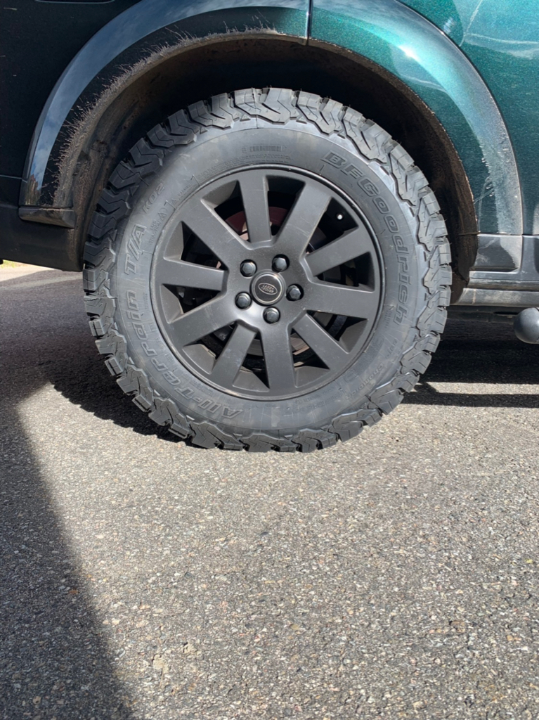

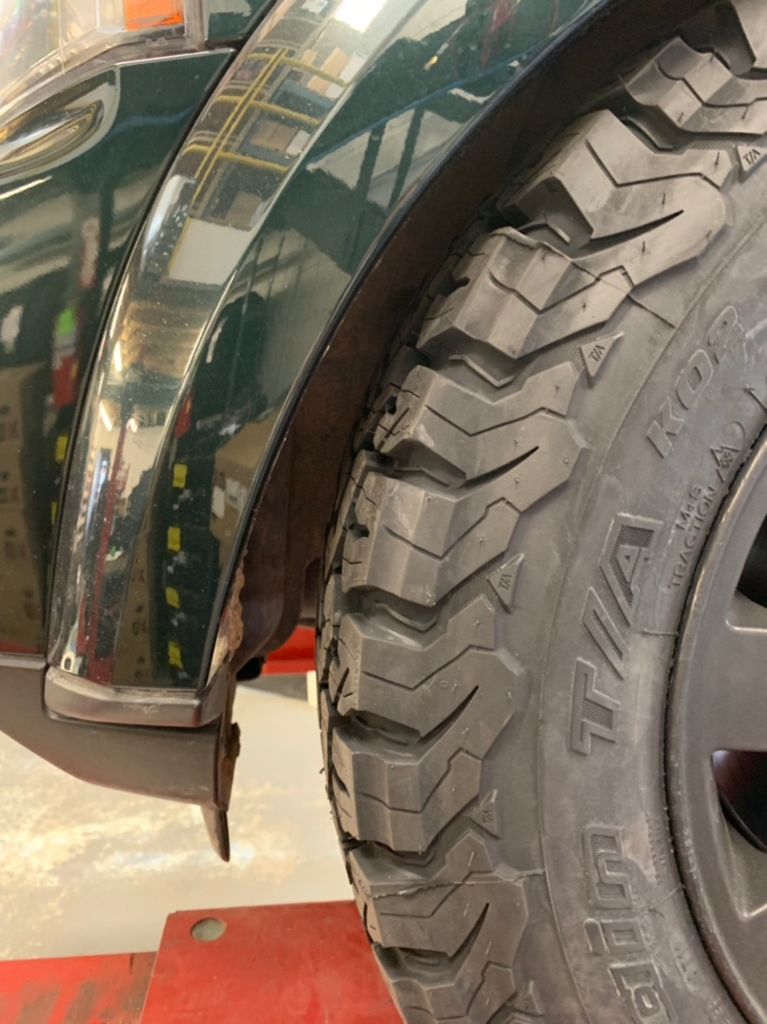

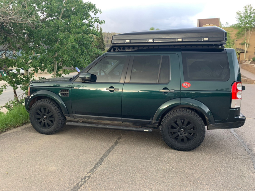

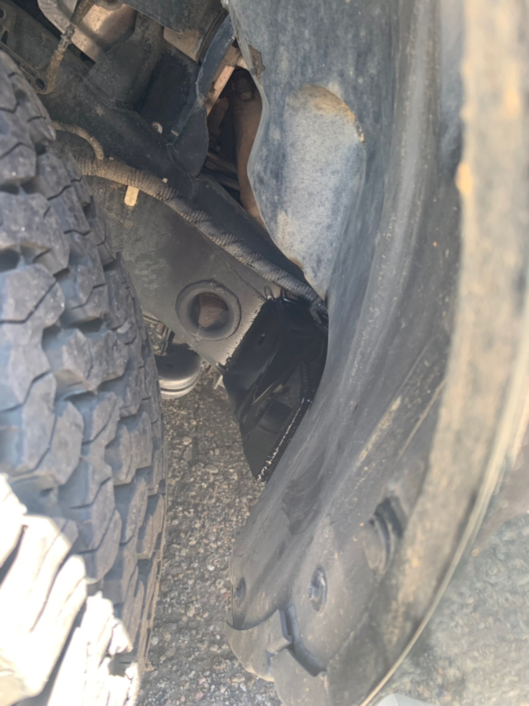

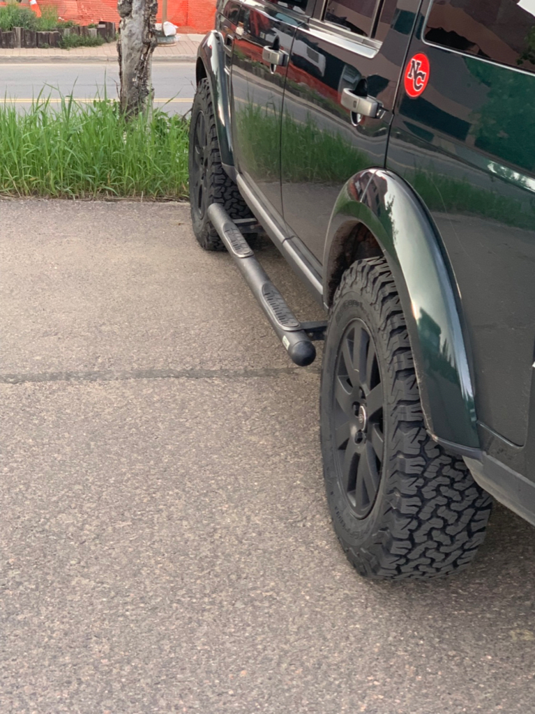

2012 LR4
LR3 wheels
Spacers 1.0”
BFG 265/65/18
Black gorilla nuts
New TPMS added
Rubbing of frame horns at full lock
Caliper fins needed slight grinding
No luck on getting full size spare loaded (old style LR hitch mounted and didn’t have time to remove - no key)
Will get frame horns shaved and hitch off shortly - and spare fitted properly.
Big upgrade and looking forward to a Utah trip next month.
