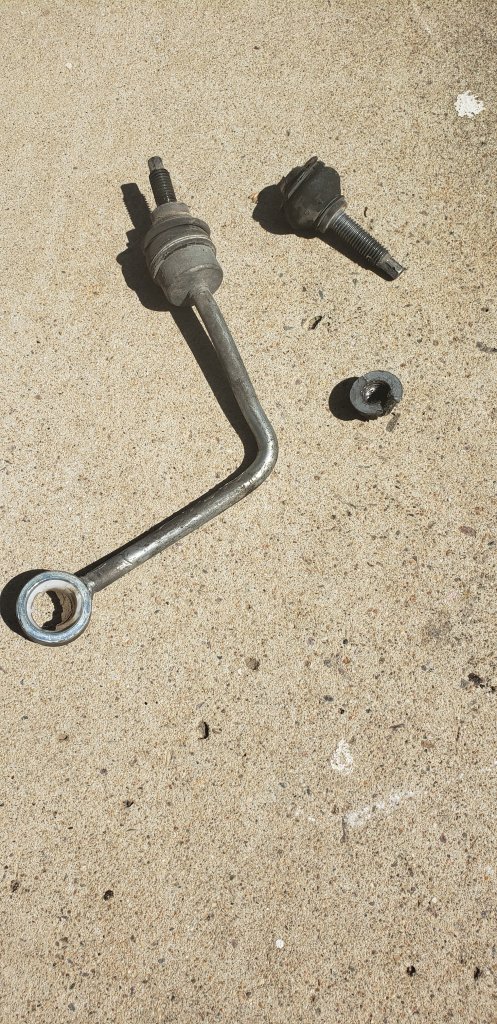

    I concur, check your sway bar link. I noticed some excessive body roll after hitting a big mound at 40 mph Dukes of Hazzard style.
    Luckily, this was all that was damaged. Was still able to drive, but felt a little off.
