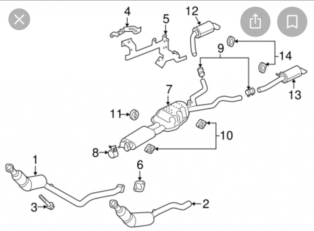

Seems like not many people doing exhaust modifications on the LR4, except a muffler delete. While it sounds good, it might be a little loud for my needs.
I'm looking for something I can actually hear, without waking up my neighbors when I get home at night with minimal/no drone.
What do you guys think about replacing the center muffler (#7) with a Magnaflow (or similar Flowmaster) straight through muffler and leaving everything else intact?

I would be interested in a mod to get rid of the 2 pipes running underneath the rear suspension.
After laying in the driveway gazing up into the rover for about an hour, I am fresh out of ideas though.

exactly what i did on mine when I had my converters replaced. Removed the center 2 mufflers and left the ones on the exhaust tip end. Replaced with a single dual input/output magnaflow. Really happy with the results. Quiet enough the kids still stay asleep in the back on trips but opens up when you press the accelerator.

Replaced the center resonater with an H pipe, replaced the center muffler with straight pipes, left the rear mufflers, not the quietest by any means, but definitely sounds good and gets lots of looks while driving. My wife dailys my LR4, with 3 kids 5 and under, they don't complain at all ‍♂️
